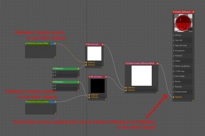

I created this little Shading network to better Exclude the Refraction and Reflection of an object on the other objects and have more control over them. it is working really well!
is there any chance you fix the opacity issue on your OSL script? or if is there a way to group that shading network in one window and make it with just one output that I can attach to Any Material Opacity?
for now, the LiveDB material I attached here is working fine!
thank you guys.
