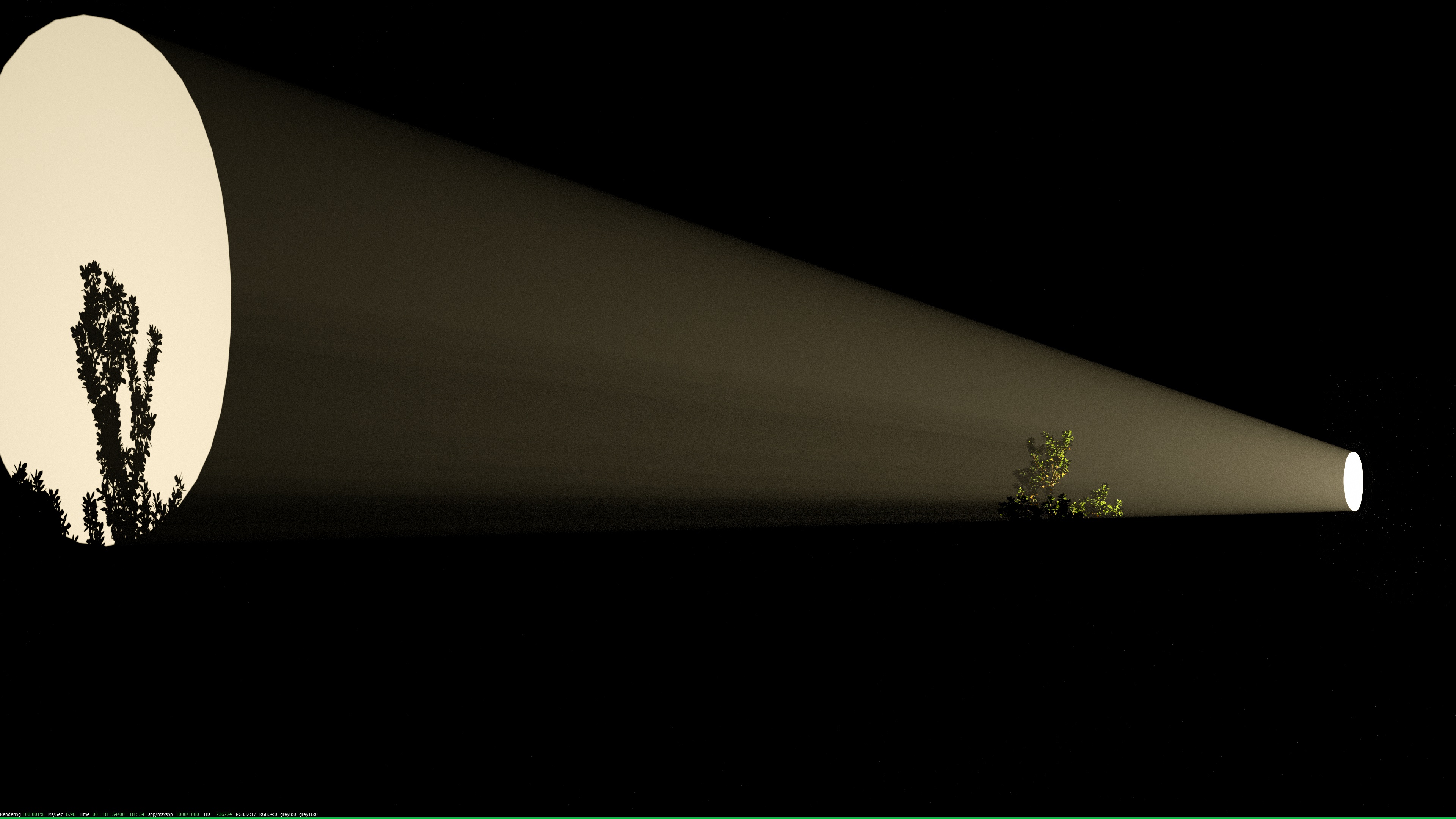

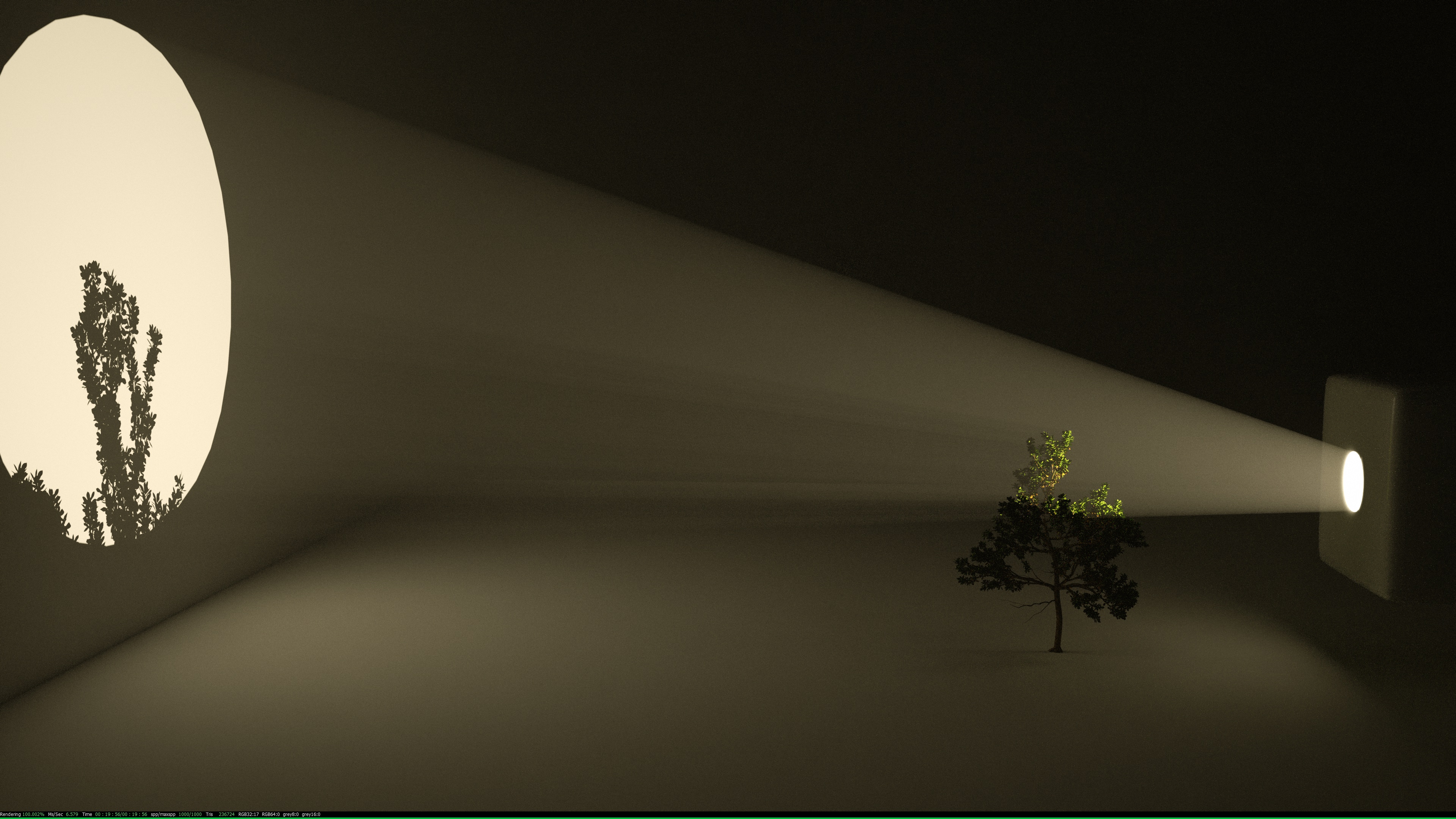

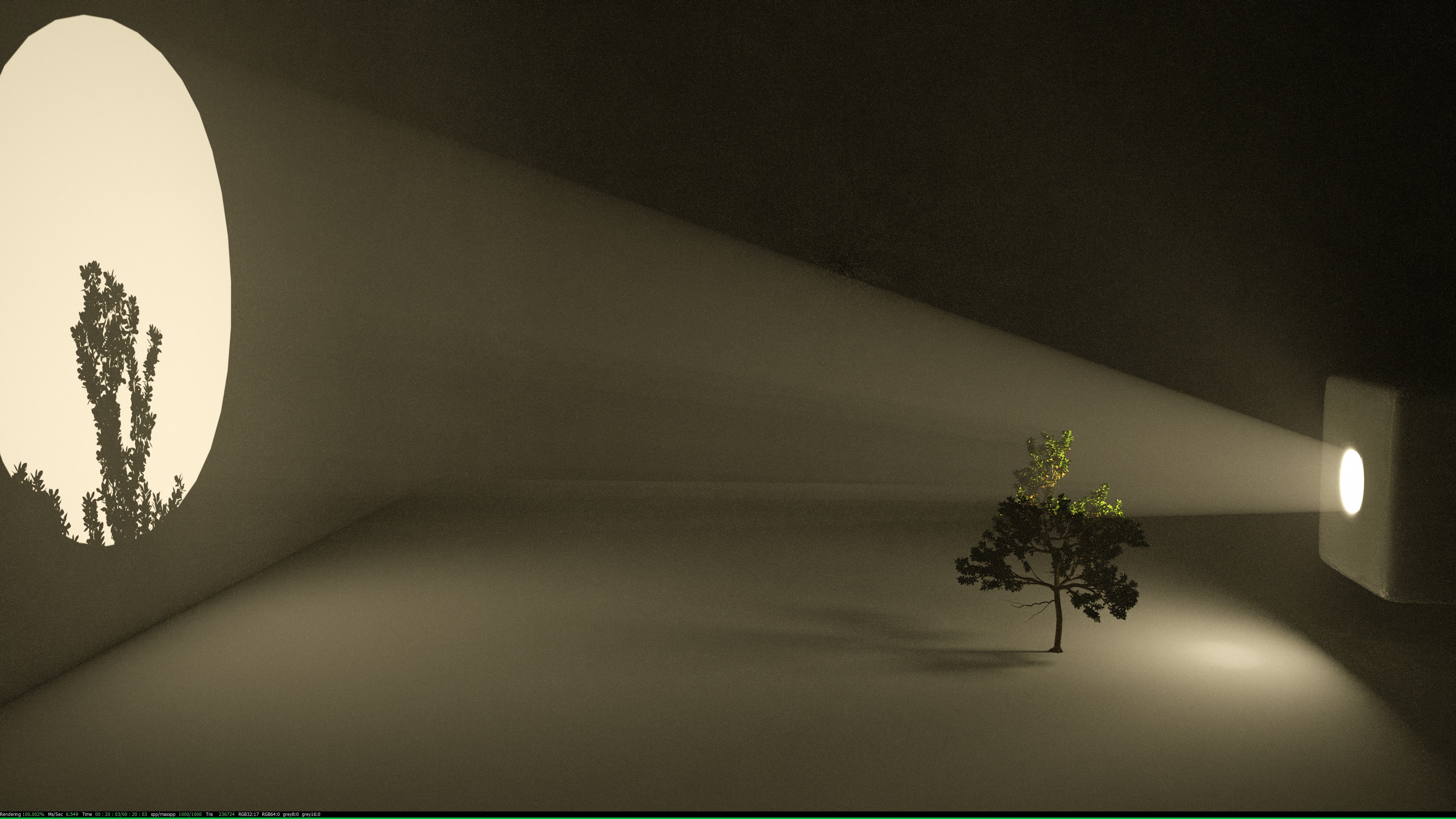

I have 3 images, each containing 1000 passages rendered by pmc time here.
As you can see the light in the image becomes less and less, lower the GI clamp is setting.
The first image with 1 million 1.000.000
The second picture with 5.
The third image I know with the GI clamp with 0.01
Honest said, somehow nothing real to begin.
Between the first picture with 1 Mill. and the other with 5 or 0.01 one sees in the light no real difference what concerns the rushing.
The pictures have been provided in a 4k resolution.
Greetings Rudi

Now well as one sees in the pictures, reflections are swallowed bulky, the smaller the value GI Clamp becomes.
With daylight to pictures it probably plays no role, but pictures, quite darkly are become darker and darker.
The light dispersion decreases just.
I never had Fireflys with pmc.
Or are the Fireflys in the last picture? GI Clamp 0.01.
