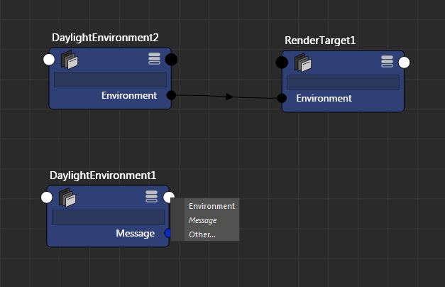

3/ Node Editor:
Playing with the new nodes from alpha 8.0 in Maya node Editor can be really really good :) , nodes like they should be,
but this experience is only great with two conditions :
- Attribute Editor must be hidden (using channel box)
- nodes must not be created from the "create node pane".
If the Attribute Editor is open, the Node Editor become laggy,
I know that the attribute Editor is a work in progress and I guess the old AE callbacks from V2 are the reasons for the slowdown and for other bugs in Alpha 8.0,
so please get rid of the old code as soon as possible ;)
If nodes are created with "TAB", or with the createNode command, or with the (excellent) Janitor tool from Ivankio, then everything is fine,
the nodes only have 1 output displayed so the connections are quick and straightforward like in Standalone just one drag to connect 2 nodes.
But if the nodes are created with the Create Node panel, the message output is added to the nodes,
so as there is now two output, the connection process is slower again, from pop up list to pop up list...
I found that the Create Node panel use the shadingNode command in renderCreateNode.mel to create the nodes (instead of the createNode command),
with this command a hidden connection is added from "message" attribute to type sets (material , texture , light, utiliy , ...) used for the Hypershade section tab...
Not sure how to solve this Maya issue.
Also, shouldn't each different output from the new nodes have a specific data type instead of "apiPointerData" for all ?
this would help maya to minimize the destination pop up list,
or direct connection when there is only one destination of this type.
