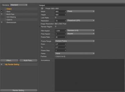

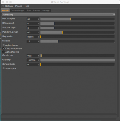

Here are my render settings:
Current Octane Render Settings
C4D Render settings

if you're comparing same scenes on demo and commercial versions, they are same. But you should check gpu section and select priority options. You're one single and slow graphic card. Octane and viewport shares the power of same card. If you don't select priority so Octane will use most of execution time of gpu. Simple enough?

Thanks for your reply. Yes I know it's not a great Video Card. I actually went thru the settings and ticked 'Use pri' for my GPU and it started responding A LOT better. I am able to do everything as before.

It should be very slow against a 780/980. Also use priority=LOW. And i advice to take a look to this test version. It's better for speed.
