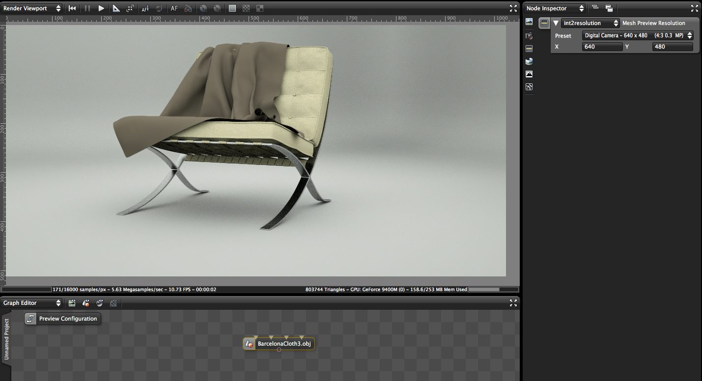

from the first tests I can report some issues I noticed:
1) Octane doesn't quit properly: cmd+Q close the window but does not kill the app, closing from the menu bar crashes Octane (I'm confirming what somebody else already said)
2) I got some weird statistics (see attached screenshot: with 0.81a under win7 bootcamp I had about 0.6 Mspl/sec for the same scene using a 9600GT (slightly different PoV since I can't save but...); elapsed time is totally wrong (and it's not related to Mspl/sec error... i mean time it's not running slow so I get more samples per sec), sometimes Mspl/sec goes to 0.00, etc...
3) although I changed the resolution to 640x480 the render size remains the same (default 1024x512)
please let me know if I'm doing something wrong (i.e. "operator error"
