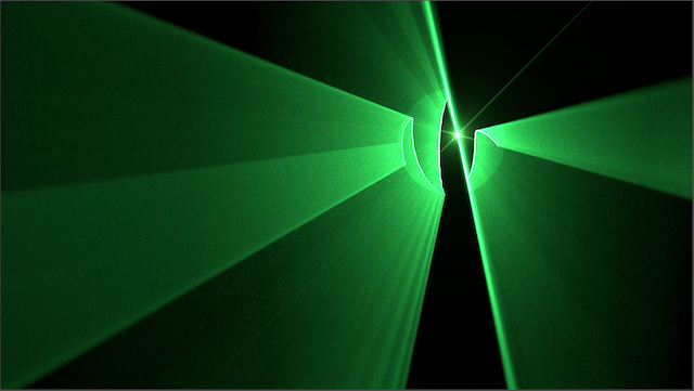

I'm trying to create a laser shooting a thin layered beam of light through fog or smoke as in the example picture. My attempt(attached below) is not doing it and I don't know how to go about it any other way? I've solved it in Redshift in a similar way, but want to be able to do it in Octane for several reasons, I just can't get there. Is it at all possible? Or perhaps there is a "limit" of the engine itself and how it handles light, falloff etc?
Many thanks in advance!
