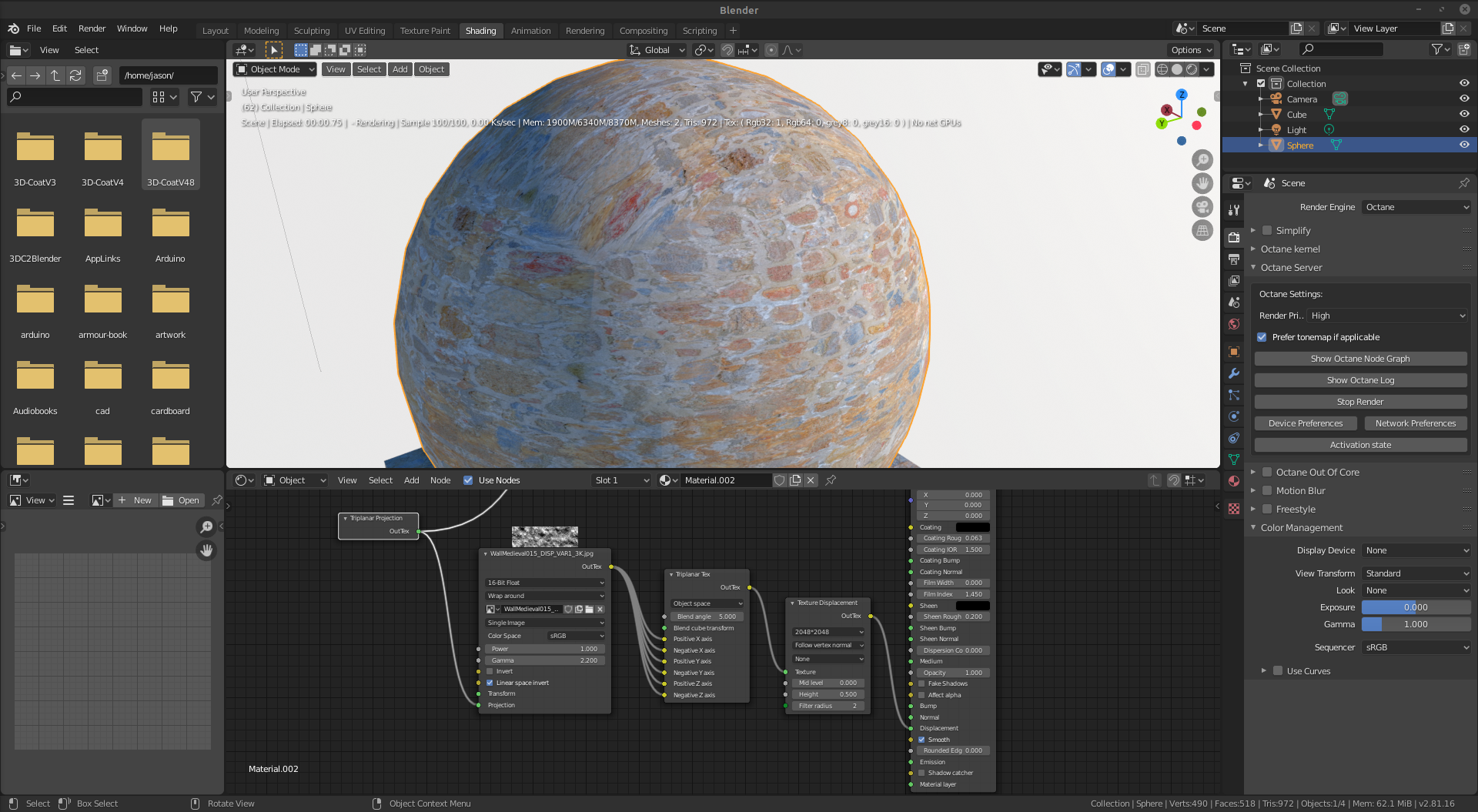

Thanks Drawfun, I got it working. My only problem now is that I can't get it to work with displacement.
I like that the Triplanar Tex node is very flexible, but it would be nice to have a single texture input pin that would just place the image on all 6 planes at once.

You need to use either Vertex displacement or use bake node to drive the Texture displacement.grimm wrote:... My only problem now is that I can't get it to work with displacement.
Jason
Texture displacement only works with bitmap textures on UV'ed meshes or with baked textures.
