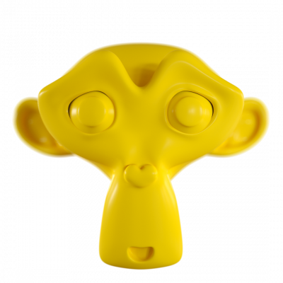

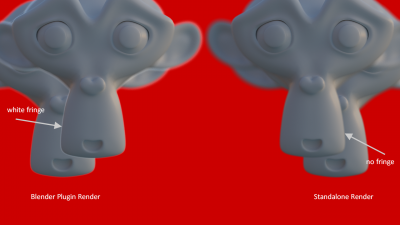

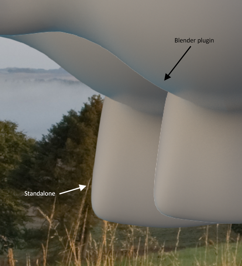

There is serious bug in Blender plugin causing white edge on an image with transparency. Standalone render fine. In both cases "Premultiplied alpha" is disabled.
I attach both versions for comparison.

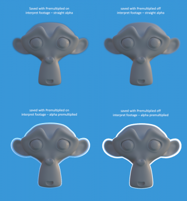

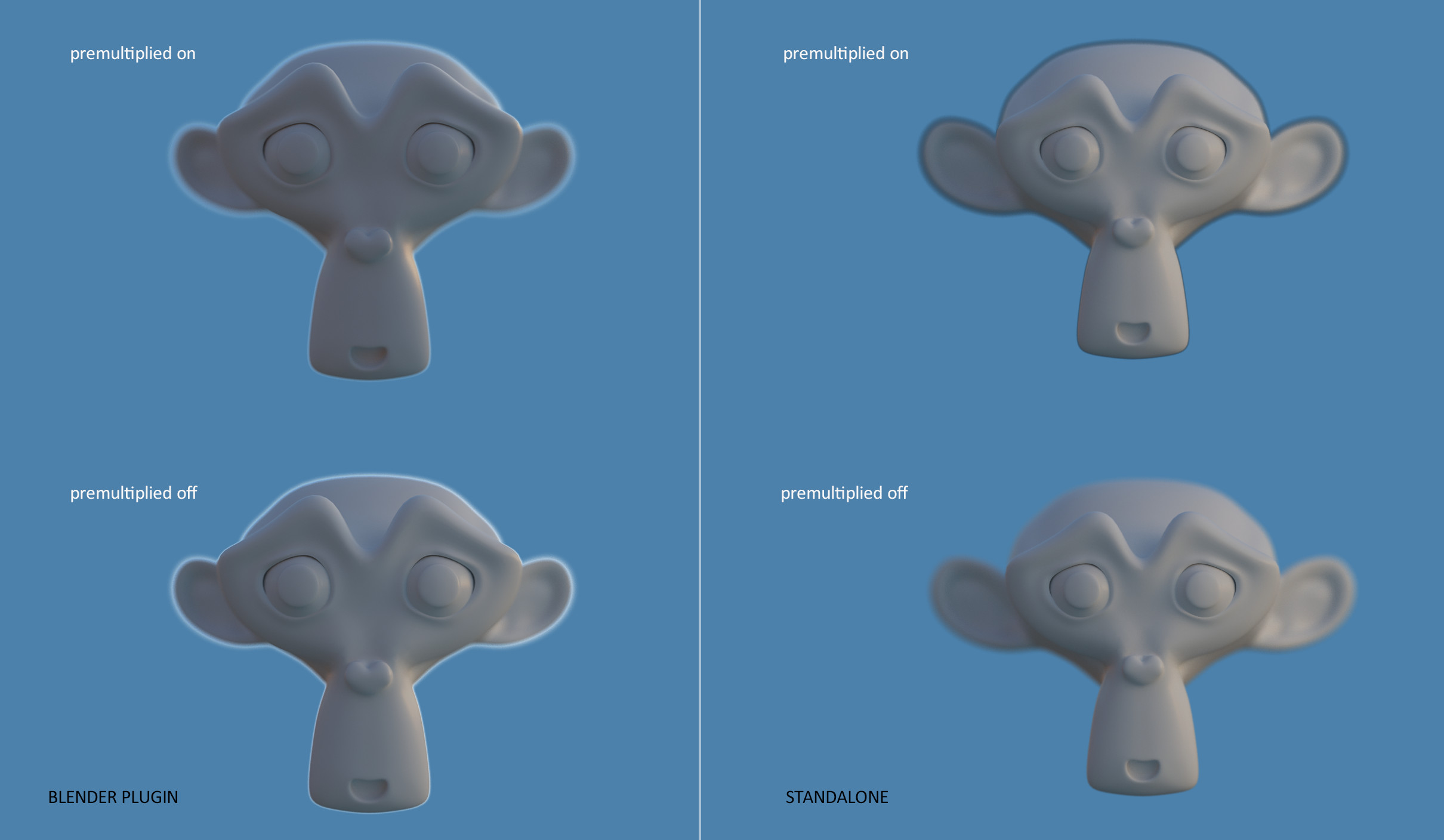

I've tried all scenarios. Same result. The file was opened in Photoshop where it displayed like this. What's strange that file opened in in After Effect behaved properly.aufwind wrote:Hi JC,
it should work if you enable "premultiplied alpha" and keep the "disabled partial alpha" unchecked.

This is how files look like when opened in Photoshop:

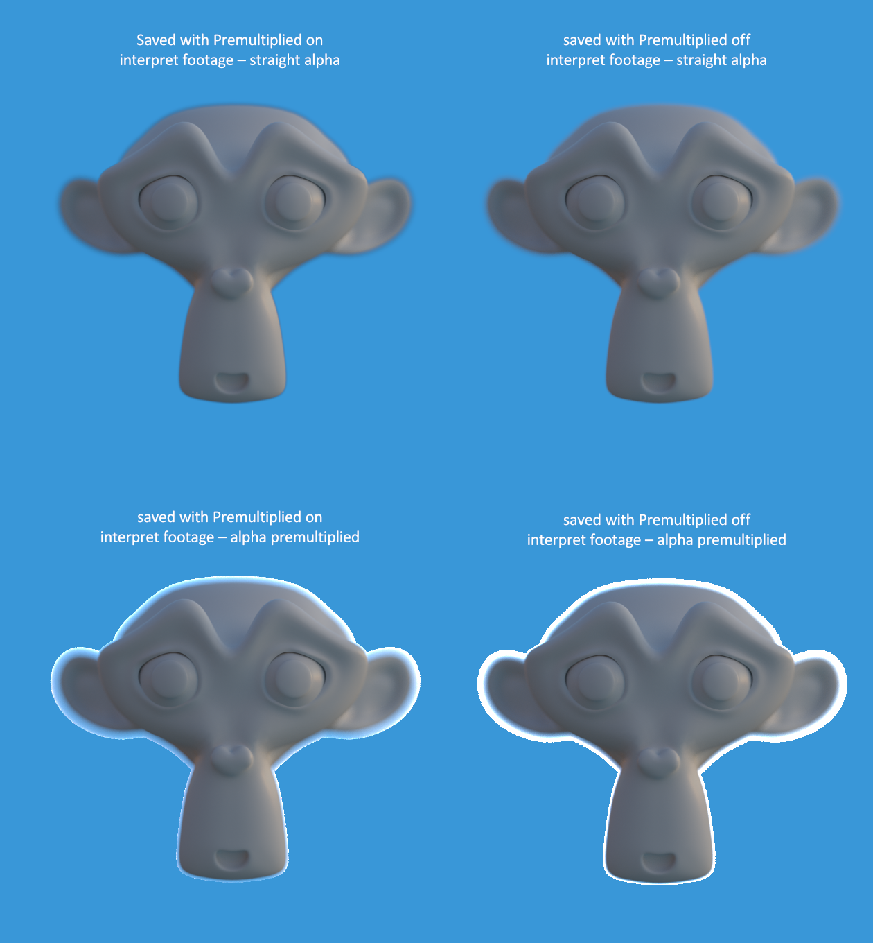

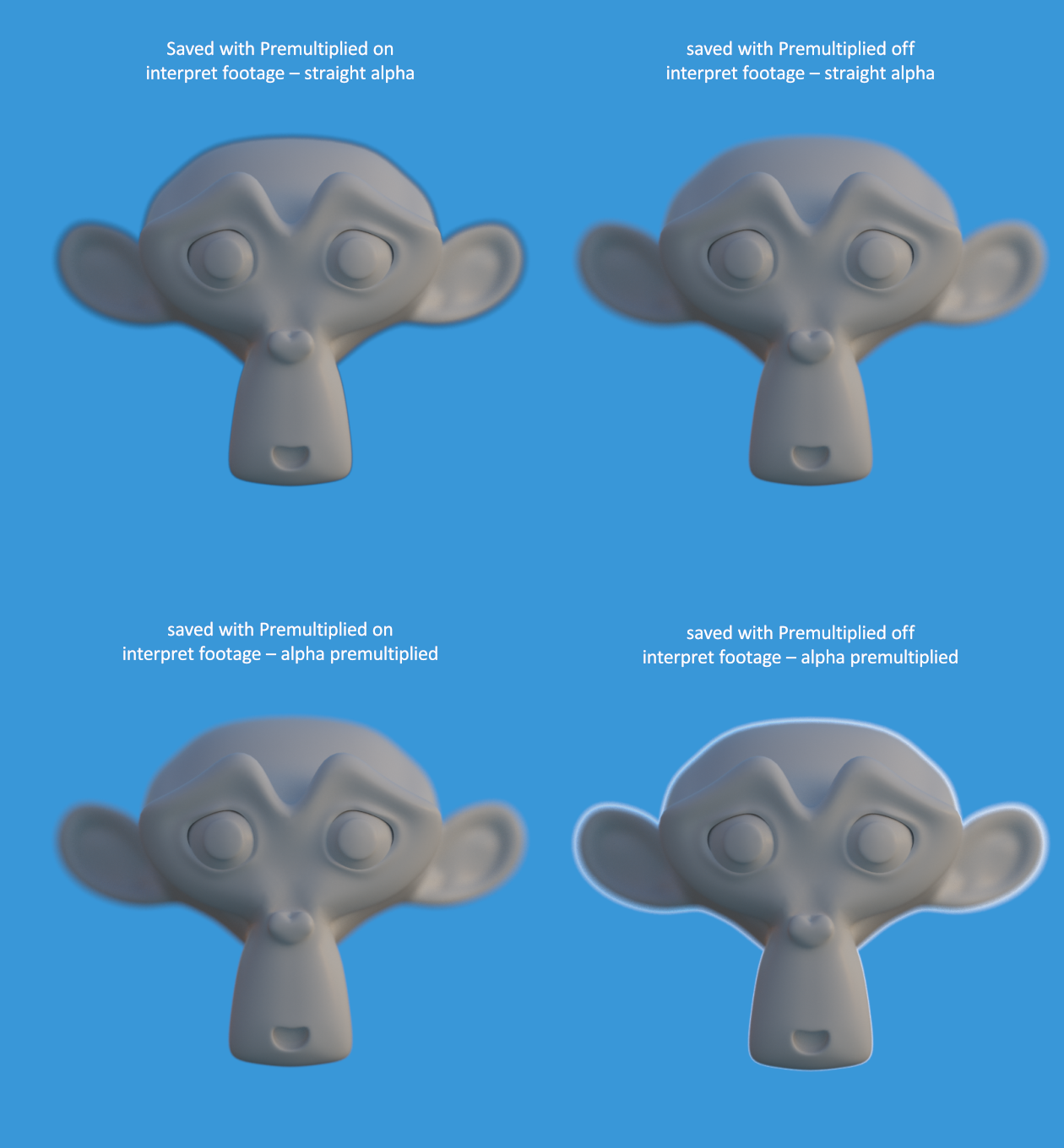

This is how After Effects interprets the Blender renders:

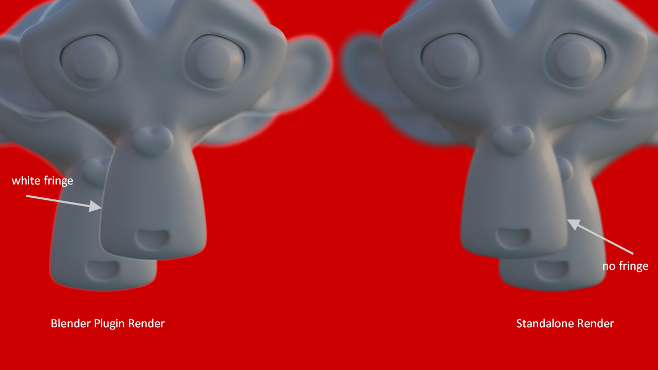

And this is how it looks like in After effects with Standalone renders:

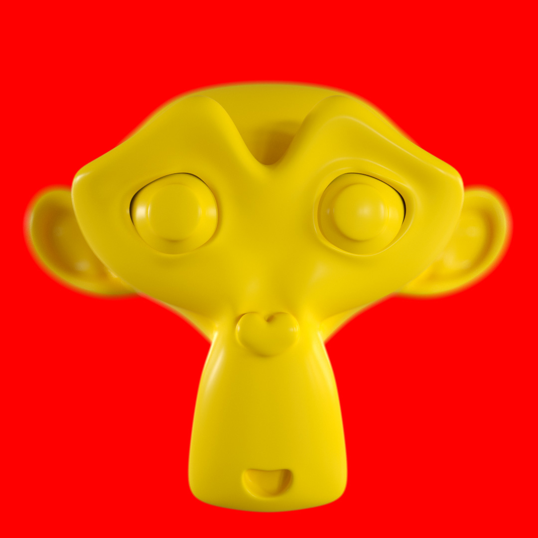

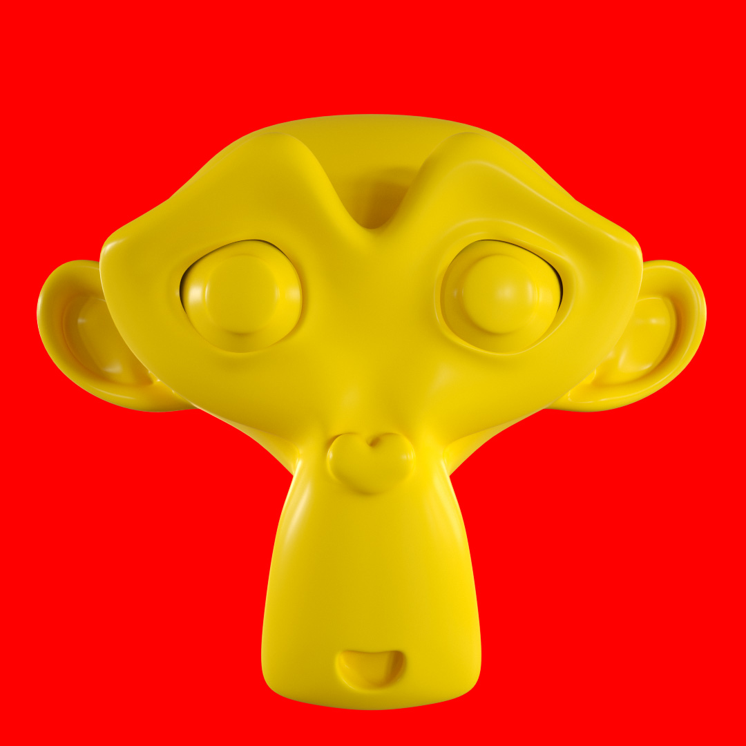

I don't know why you get these strange results. I've even tried you're Blend File.
Here my results rendered in Blender Plug-In with the Settings mentioned in my post.
Suzanne with and without DOF. Background inserted in Photoshop.

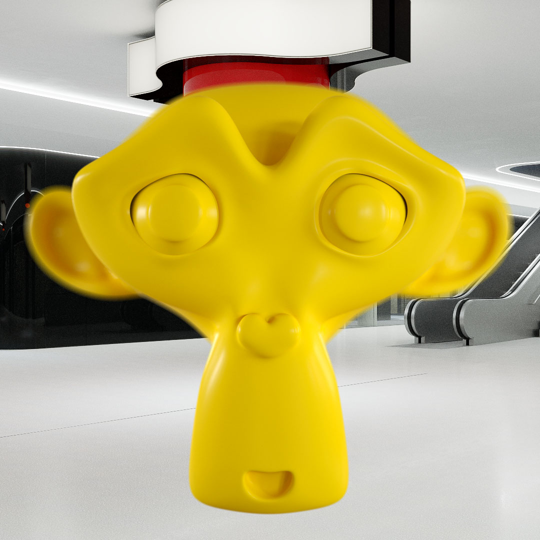

Have you tried different background like mine on the example? On some backgrounds it is more visible than on others.aufwind wrote:I don't know why you get these strange results. I've even tried you're Blend File.

Another example:

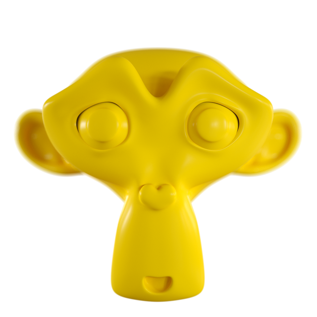

For you to try out just the Render Layer with alpha channel Export and a Version with a different background.
I'm still on Octane Blender Version 3.07. So maybe it is a Problem with newer Versions or just some setting problems in Photoshop...
