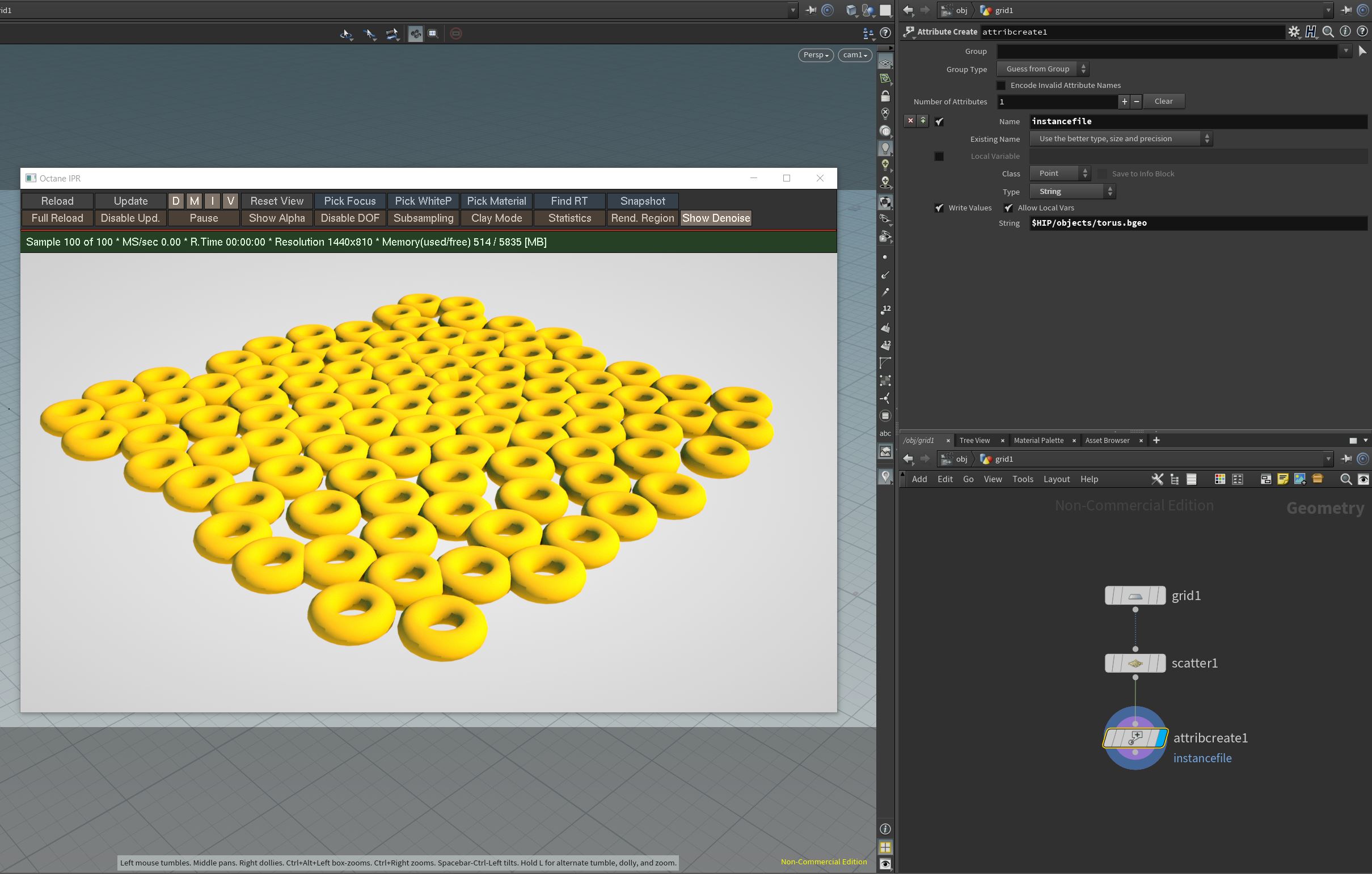

You can instance .bgeo objects. There is nothing special about this feature, as you can see in the attached image. You only need to declare the attribute pointing to the .bgeo file that you want to instance at this point. The material can be set in the instancer OBJ node.

I see, the problem was, I was using compressed files (with the .sc at the end). That doesn't seem to work. With .bgeo files it works.
