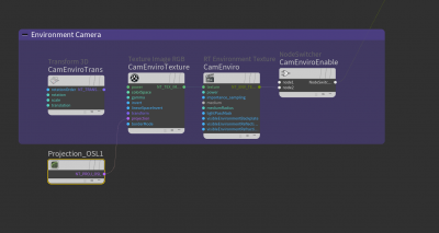

Renbry
Posts: 43
Joined: Fri Nov 23, 2018 9:09 am
@muchogrande - here's a snipping showing how the Projection OSL gets plugged into the existing node network. Specifically the PROJECTION plug on the CamEnviroTexture.

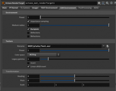

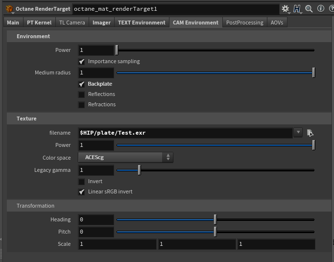

Then you'd just need to make sure your Render Target has Cam Environment turned on in the MAIN tab to make visible the file name selector to choose your background image
