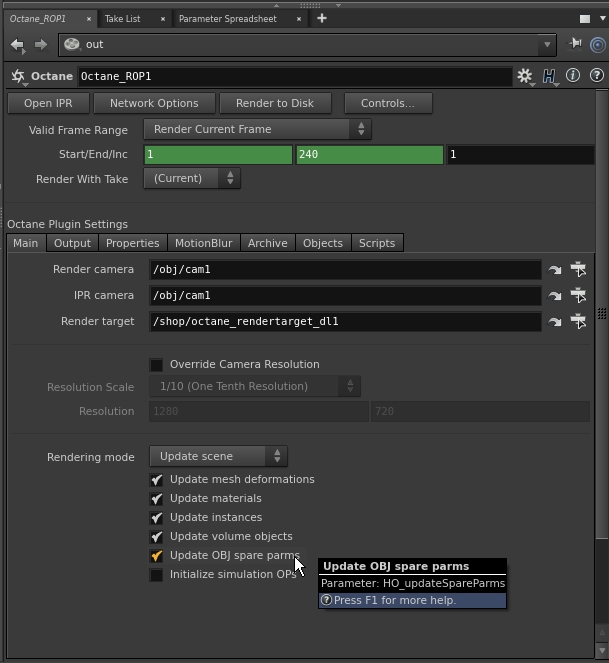

The next plugin build will have a new option in the ROP node to enable the update of some of the OBJ spare parameters while rendering in update mode, like the visibility options and the emission features.
-Juanjo
