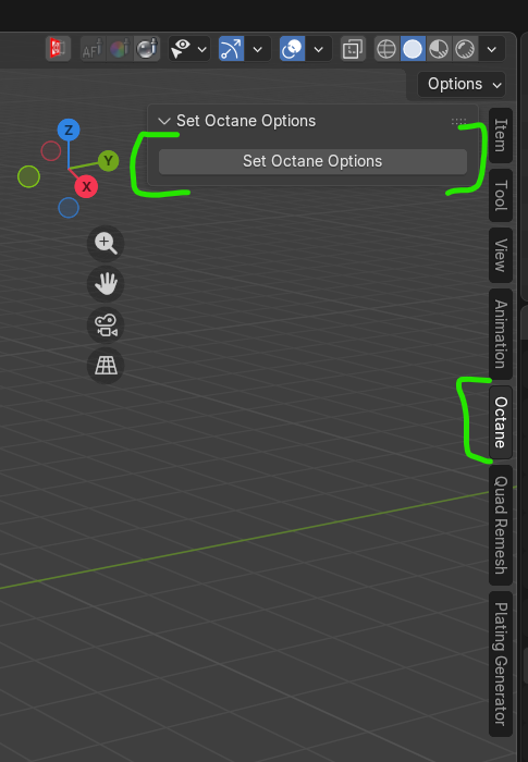

If you need to setup Octane's general basic options, please use this addon:
viewtopic.php?t=83942
Once installed, you'll find a new option in the 3D view:
This is not "destructive", and pretty useful if you're starting from a Cycles scene.
