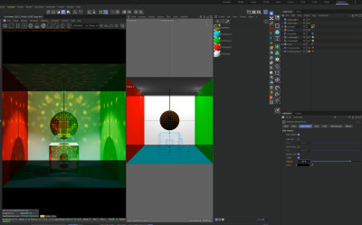

here's a screenshot of the safe frame not working in the octane preview window.

Ok, set the Opacity lower than 100%, even 99%, in Safe Frames attributes:
