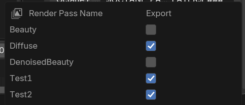

NEW FIX: Add an option to exclude AOVs from being saved to EXR
An "Export Render Pass Settings" is added on the Octane Output panel. Click the button then a Standalone-like panel will be shown and user can configure their export AOVs there.

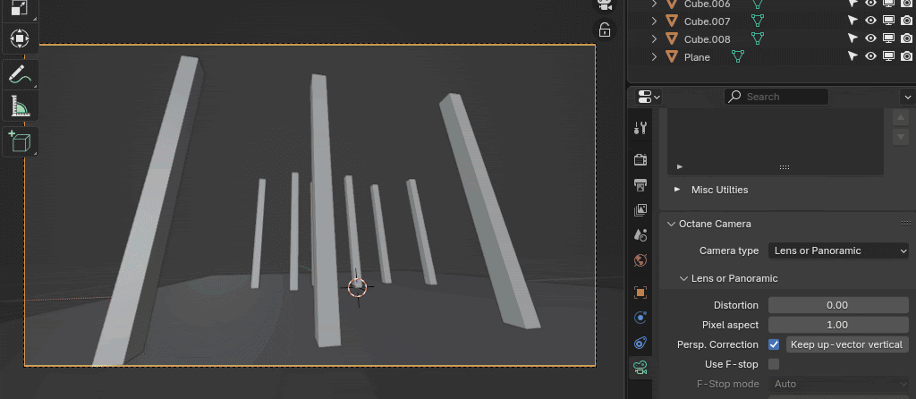

NEW FIX: Perspective Correction option not working
When the "Persp. Correction" is enabled, a "Keep up-vector vertical" option will be shown.
Enable it to make sure the "Persp. Correction" work as expect. Besides, "Keep up-vector vertical" is only valid when "Persp. Correction" is enabled.
Please note this "vertical change" may cause differences between rendered image and Blender viewport.
