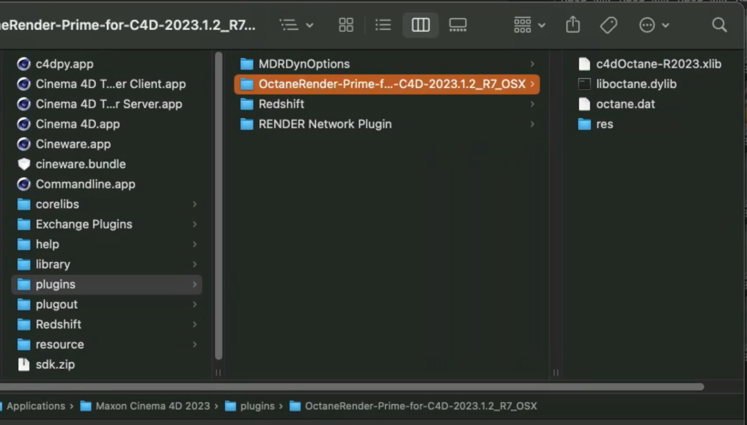

ok, please also share a screenshot like this one, that shows both c4doctane directory opened, and the entire installation path, thanks:
ciao,
Beppe

this looks pretty much the same. Only difference is I renamed the folder to "OctaneRender" to shorten the long default name in the C4D extensions. But I handled it before like that and lens flare was working.
Best,
Lars

ok, please close C4D, then change the name of the folder from "Plugins" to "plugins" in lowercase:
ciao,
Beppe
