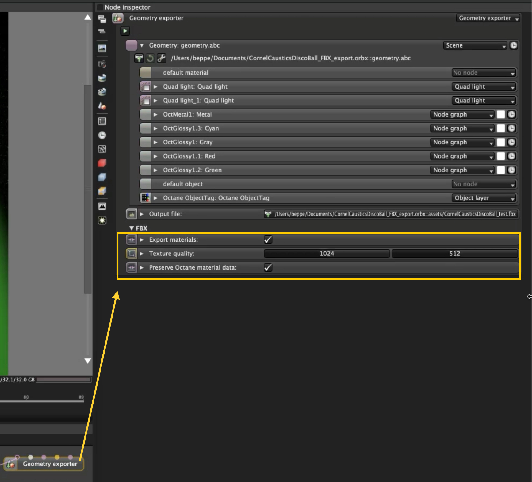

OctaneRender Standalone has an FBX exporter that can save Octane materials, if they are Octane Univeral Materials, but unfortunately, C4D doesn't consider them in import:
