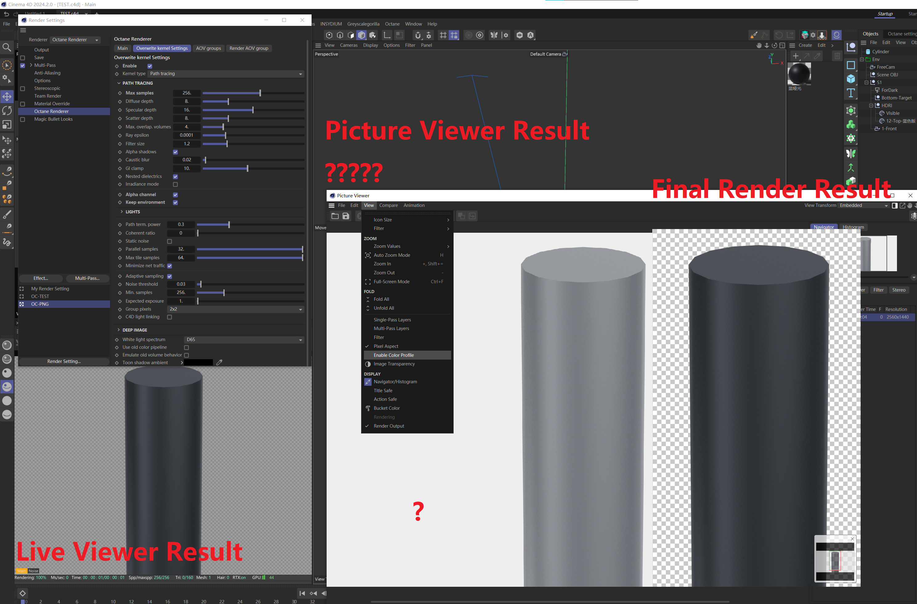

The newest update of C4D 2024.2.0 has ton of bugs when pair with Octane, Sometimes it will render a Whole Black PNG with transparent background.. Sometimes when I click the render button, this particular version of C4D will require much longer time to prepare and load the asset to the live viewer (3-5 sec longer). And another annoying bug and the most important one is bothering me so bad. Please check the screenshot below. I post a sample setting file below. Am I doing something wrong here? As long as I try to render a PNG with Alpha, the picture viewer color is getting washed out like few years ago when I first have this problem....... :oops:
Yes, I know how to fix it before and the end result is good no matter what, I used to fixed it by disabling the C4D internal Color Profile setting, but that button cannot do anything now.
Please check the project file below and kindly point me where I did wrong. Is it a bug or feature?
Thank you in advance!

911ljt wrote:The newest update of C4D 2024.2.0 has ton of bugs when pair with Octane, Sometimes it will render a Whole Black PNG with transparent background.. Sometimes when I click the render button, this particular version of C4D will require much longer time to prepare and load the asset to the live viewer (3-5 sec longer). And another annoying bug and the most important one is bothering me so bad. Please check the screenshot below. I post a sample setting file below. Am I doing something wrong here? As long as I try to render a PNG with Alpha, the picture viewer color is getting washed out like few years ago when I first have this problem....... :oops:
the sample project file with render setting
TEST.zip
While saying tons of bugs? You say a fews...
Btw did you try without GSG in environment object? Performance difference maybe related to this.
Also I can see the black environment on some restarts on to LV.
Last, I'm on 2024.1.0 and no problem with "color profile settings". It works well here, I'll try with 2024.2.0
UPDATE: "Enable color profile" is not doing anything with 2024.2.0. Maxon is internally changing the stuff and this causing several problems. I have to find and fix the issues when they do something is working different. It may be related this changes or a bug, not sure. Stay with previous build if it's possible.

Thanks ahmet for your incredibly fast reponse, I will tried to upload a scene when the bugs i memtion can be generated 80%. they happened too randomly and I m now switched back to 2024.1 for good measure. They definately change a few thing with third party plugin and made some wierd bug along the way.
Thank you for notifying the Color profile setting bug!
The attachment Screenshot.png is no longer available
The attachment TEST.zip is no longer available
I have used your project to render it, and there is no problem in rendering it as a picture, it has transparency.
Maybe you should open "Image Transparency",
It will display transparency correctly in the c4d image viewer. Even without opening it, it just doesn't show transparency.
The rendered picture is correct.
