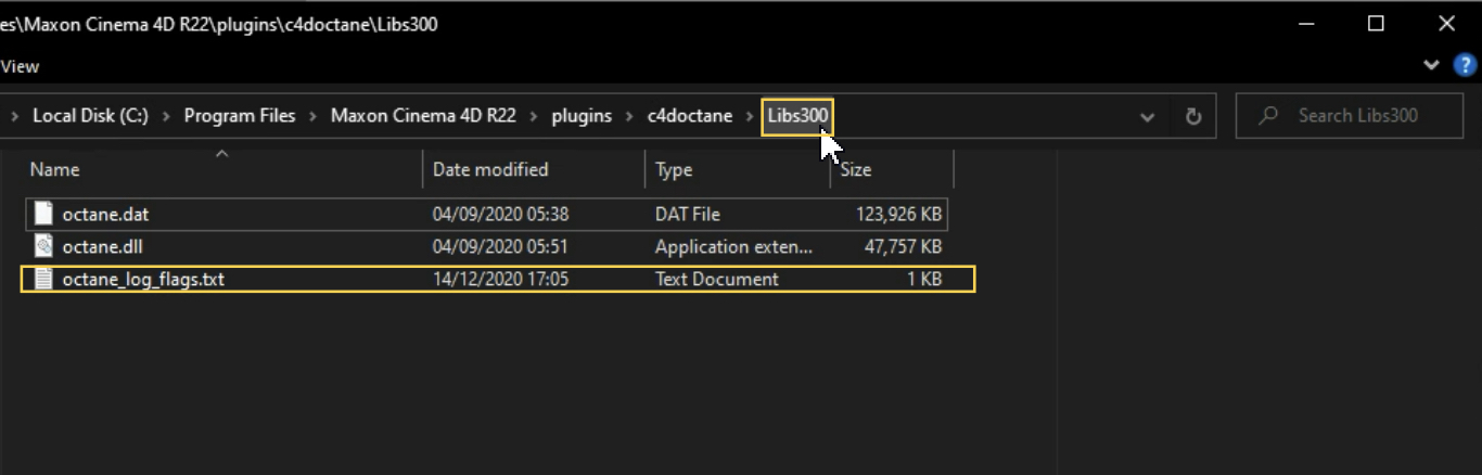

Please copy the attached “octane_log_flags.txt” into ../plugins/c4doctane directory:
(106 Bytes) Downloaded 174 times
Then please, open the scene, then go to c4doctane Settings/Log Output tab, and enable all the Log option checkboxes.
Then, load the scene in Live View, then in Picture Viewer until crash, then reopen c4d, navigate to c4doctane Settings/Log Output tab, press the Generate log report button, and share the resulting octanelog_report.zip file, thanks.

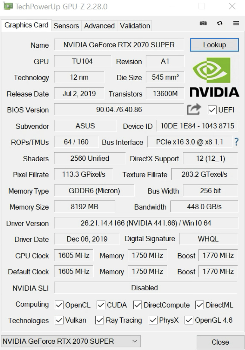

Please, also download and run GPU-Z:
https://www.techpowerup.com/gpuz/
And share a screenshot from the Graphics Card tab, for all the available Nvidia GPUs, thanks:

Here is the log report you asked for and the screenshot.
