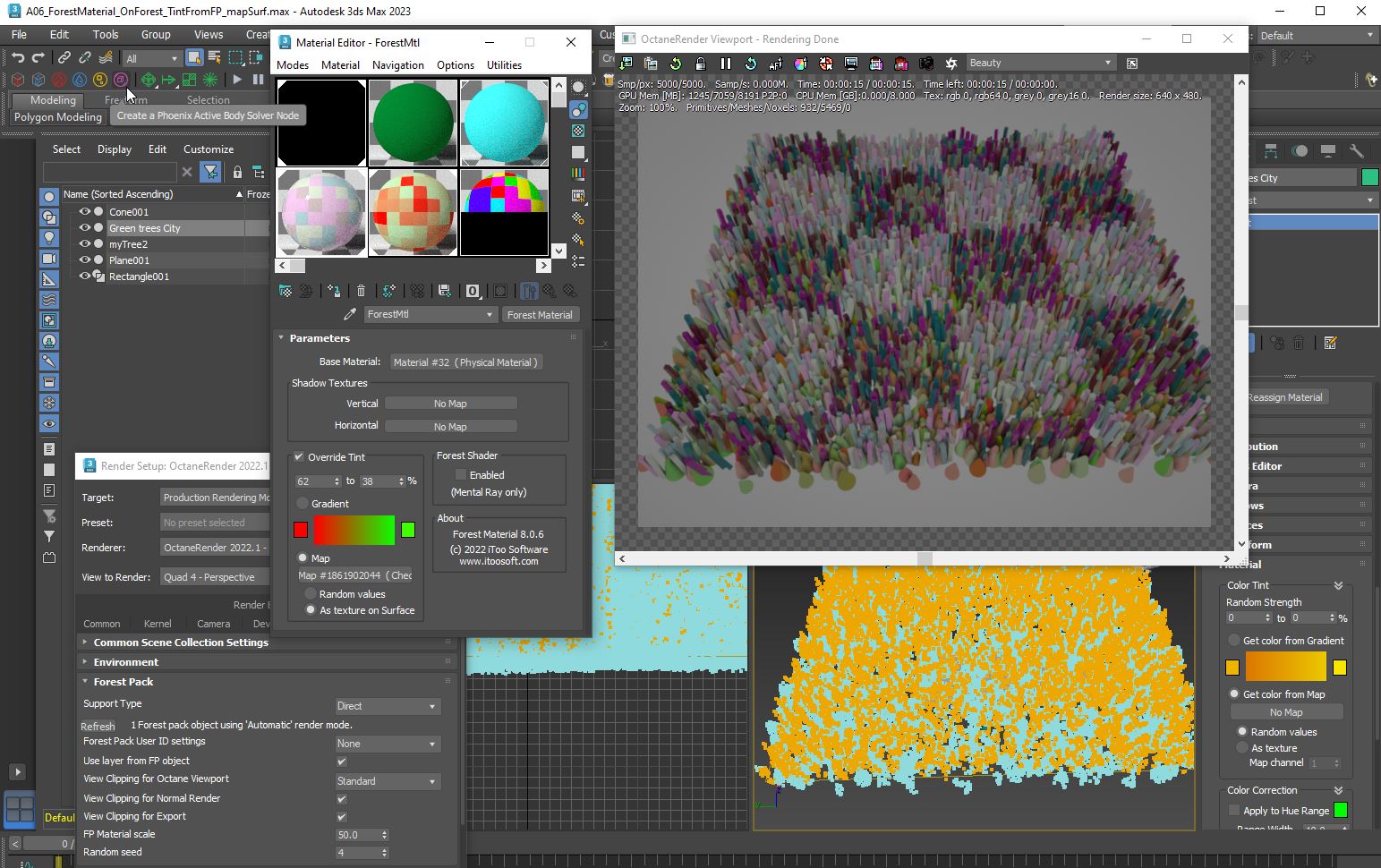

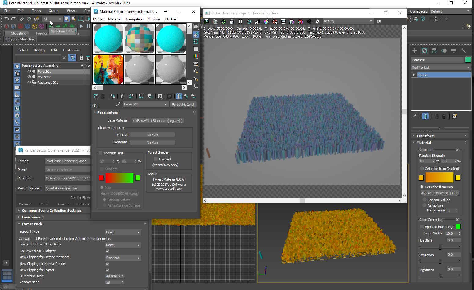

A05_ForestMaterial_OnForest_TintFromFP_map.max
The Forest Object tint uses a map, in Random values mode. Here we used an Octane Flake texture.
A06_ForestMaterial_OnForest_TintFromFP_mapSurf.max
The Forest Object tint uses a map, in As Texture on Surface mode. Here we used an Octane Checks texture.
Use the Render settings / Support / Forest Pack / FP Material scale to adjust the size of the Checks texture.
