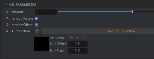

It is possible that the Cinema4D plug-in is not able to map the type of that input to a UI widget. This is a version with 2 float inputs for the tile size:
Re: OSL Random Tile Texture
Posted: Mon Dec 05, 2022 1:10 am
by SSmolak
roeland wrote: It is possible that the Cinema4D plug-in is not able to map the type of that input to a UI widget. This is a version with 2 float inputs for the tile size:
It looks good now except text strings :
Thank you for creating this. I will test it soon :)
