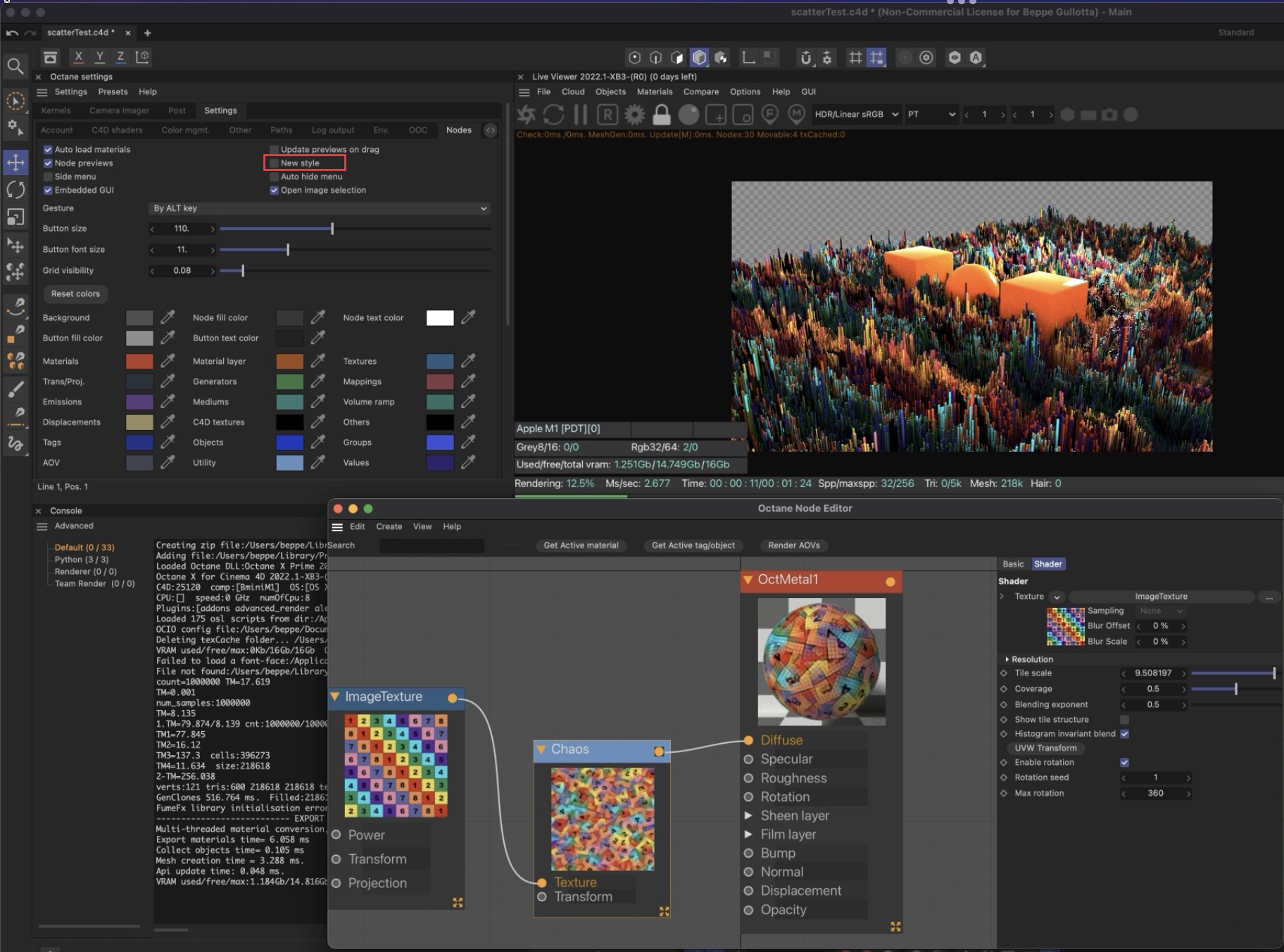

For C4D 2023, you need to keep the R27.xlib file, and remove both R25 and R26.xlib files.
Note that you need to go to c4doctane Setting/Nodes, and disable the New style option, or material preview doesn't work in node editor:

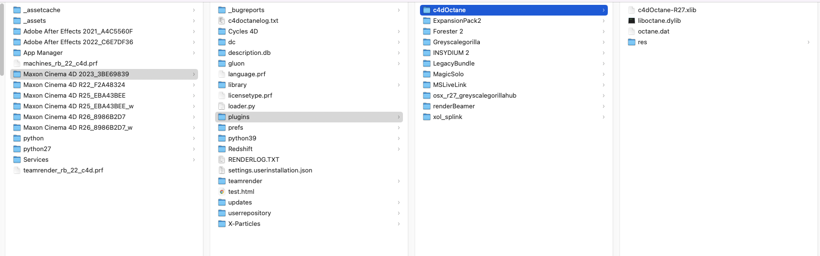

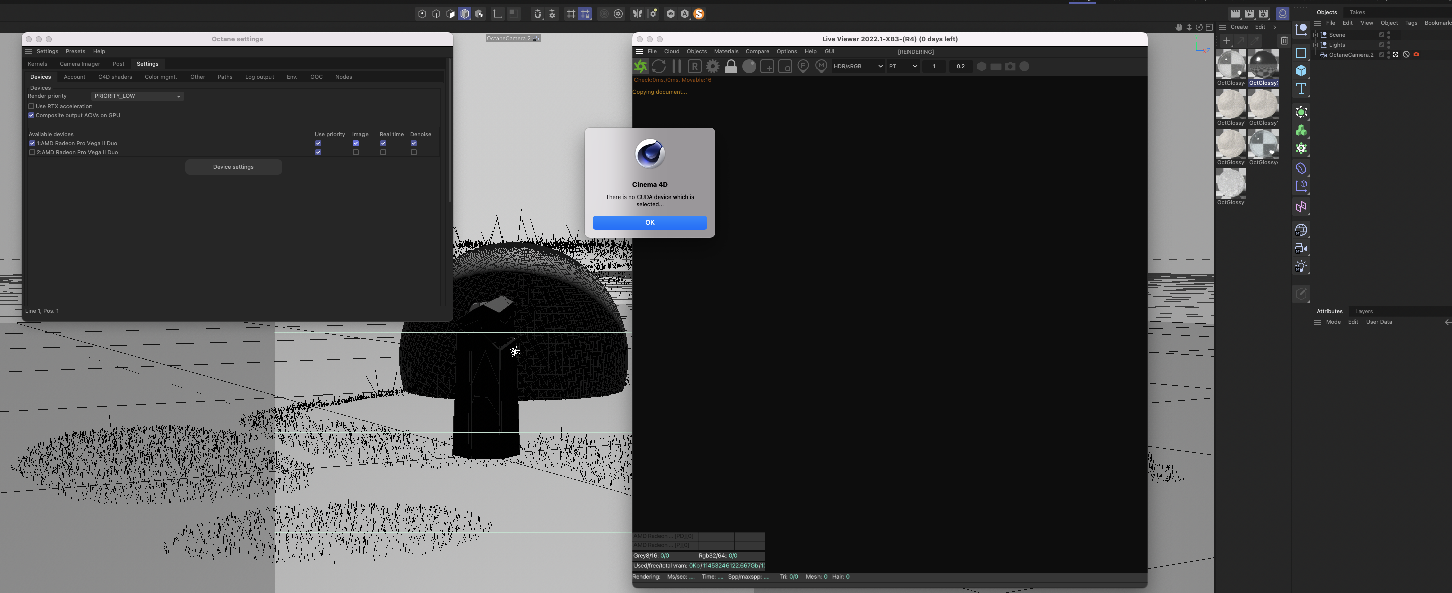

I tried your link/directions above, but continue to get this error message:
There is no CUDA device which is selected...
Tried every combination of selecting the devices in Devices/Available devices settings, but always get the same error message.
Mac Pro (2019)
Processor 3.2 GHz 16-Core Intel Xeon W
Monterey 12.6.1
GPU: AMD Radeon Pro Vega II Duo 32 GB
Using the plugin in the link you provided (c4dOctane-R27.xlib), I tried to get this to work on C4D 2023.1.2, and then updated it to 2023.1.3
Also, i tried using (c4dOctane-R26.xlib) in the link you provided, with C4D R26.015, but i get the same problem.
Do you know what could be the problem, and how i can fix this?
Screengrabs attached.
Thank you,
-Dean

Hi Dean,
sorry, the linked version is outdated, now we are at 2022.1-R3:
https://render.otoy.com/customerdownloa ... OSX_m1.zip
But please consider that new versions are working only on Mac with Apple Silicon M1/M2 GPU.
Since your Mac is equipped with AMD GPU, you need to go back to C4D-OctaneX PR14 in C4D R26:
https://render.otoy.com/customerdownloa ... o_PR14.zip
For C4D S26, you need to keep the R25.xdlib file, and remove the other .xdlib unused files.
Please do not upgrade to macOS Ventura, since AMD GPUs are not supported.
ciao,
Beppe
