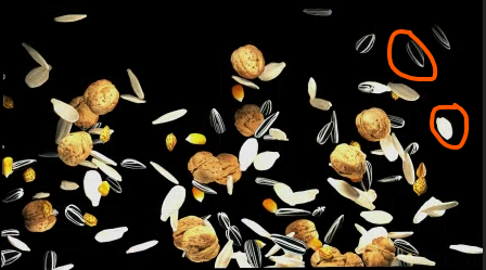

Please see the attached screenshots of the seeds and nuts – the geometry assigned to a particular particle randomly changes. This is happening on a local machine render with 1 3080 Ti.
different particles circled, its happening elsewhere in the render though to different particles.

The xpKill modifier was the problem. It must reassign the particle id when a particle is killed which is a bit crap. Seems like an XP problem rather than octane though?
