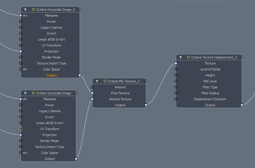

what am i doing wrong here?
i'm trying to combine 2 textures as displacement textures. i tried Mix, Multiply and Add but in all cases nothing happens (the displacement is ignored)
if i use the textures individually then the mesh is displaced as expected

Hi - use the Baking Texture to bake the texture to a physical file, which can then be plugged in to the Displacement node.

i was hoping for something a bit more interactive :)
is this an Octane limitation (not the plugin)?

It's interactive. Plug your mix texture into the baking texture node, then the output to the displacement node

There are 2 displacement nodes in Octane.
Texture displacement - fast, using voxels, but limited to single images (or baking node). Can have artifacts/leaks
https://docs.otoy.com/ModoH/ModoPluginM ... cement.htm
Vertex displacement - can use any texture/procedural. Creates real subdivided geometry, so can be slow.
You can plug a mix texture directly into Vertex displacement, but texture displacement needs a baking node after the mix.

got it working now thanks as always to you both
