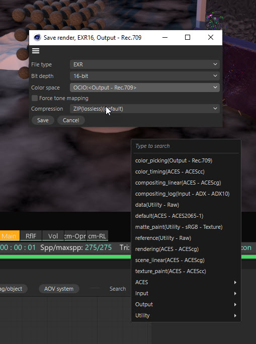

I did have a quick question. Messing around with the filmic OCIO and it comes with a bunch of different contrast curves. Rendering to PV is 1:1 as in the LV which is great, but saving an image from the LV it doesnt have the looks there. I can copy to clipboard just fine and it looks the same, but the save render dialogue has the looks missing. See image attached, is this something which could be included in the File > Save Render dialogue?

AaronWestwood wrote:Thanks Aoktar, literally submitted a ticket yesterday about the "old volume behavior" missing in 2021, so this came at a perfect time!!! You're so speedy :)
It's different on UI. I think you didn't to try to change the options. See this
The attachment a2.jpg is no longer available
Hey Aoktar
Im not sure im following. Ive clicked through and tried every single possible setting, the "Looks" just arnt there in the LV render dialogue option like your screenshot shows..
Im not talking about the colourspace, but the looks.
As mentioned, PV and Clipboard work 100% fine....just the LV render dialogue has this missing...
Hey Aoktar
Happy new year all! Just thought to re-query this to see if its do-able?
