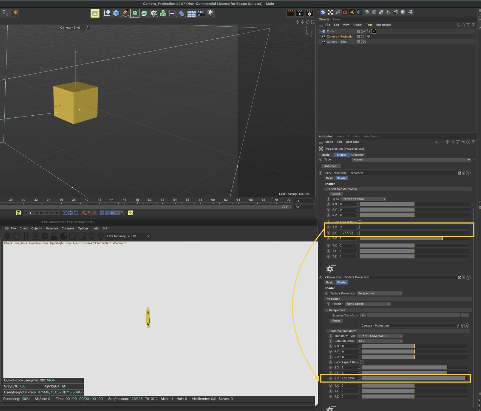

please try these steps:
- set the UV Transform X scale to -1, and the y scale to -1*weight/height
- use the Projection Z scale to zoom in and zoom out
The Camera Projection position should be orthogonal to the cube, now it is not.
ciao Beppe

bepeg4d wrote:Hi,
ciao Beppe
Hi Beppe,
Thank you for the reply. I'm sorry, but this isn't what I was hoping for:
  • This method seems really inaccurate. How can I get the right values every time? I don't want to be guessing with a scale factor that goes to the millionth's place decimal.
  • As with Cinema 4D's camera mapping, I should be able to project an image that isn't orthogonal to to the cube.
