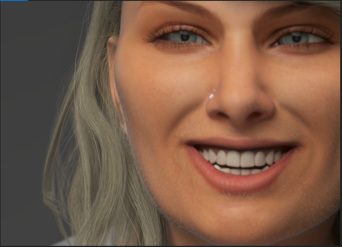

Anyone have tips for getting decent teeth and gums in the Daz plugin?
This is from the Plugin.

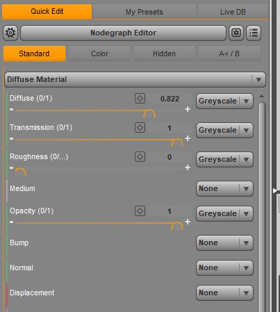

Part of my trick is to add a invisible reflector (a simple rectangle) just in front of the teeth. I anchor this to the Lower Jaw of the character so that is always stays in place while I pose the character / change expression. Just turn off the Octane Camera Visibility and Shadow Visibility
Hidden Teeth Reflector
The Teeth Reflector is a simple Diffuse material. You can control the amount of light reflected back into the teeth by changing the Diffuse value.
Simple Diffuse Teeth Reflector Material
