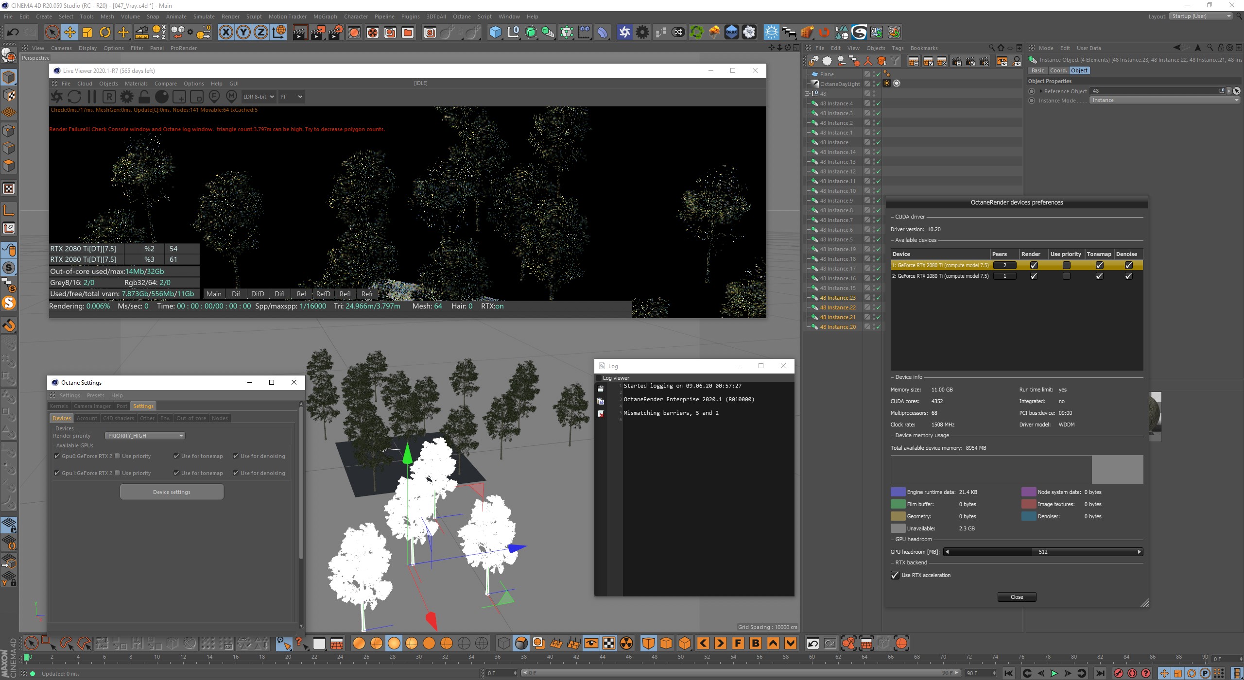

				by leehenshall
				Unfortunately I have encountered the issue again in the latest build. This scene is a very memory intensive so I think my use case is more out of the ordinary.
Here is a screenshot:
It is much more stable in this new build however but still seems to be a problem.
I am unable to see any feedback in the C4D plugin as to whether I am using P2P/NVLink. In SA I can see that there is a P2P bar in blue, presumably to indicate when and how much the scene is in P2P/NVLink.
