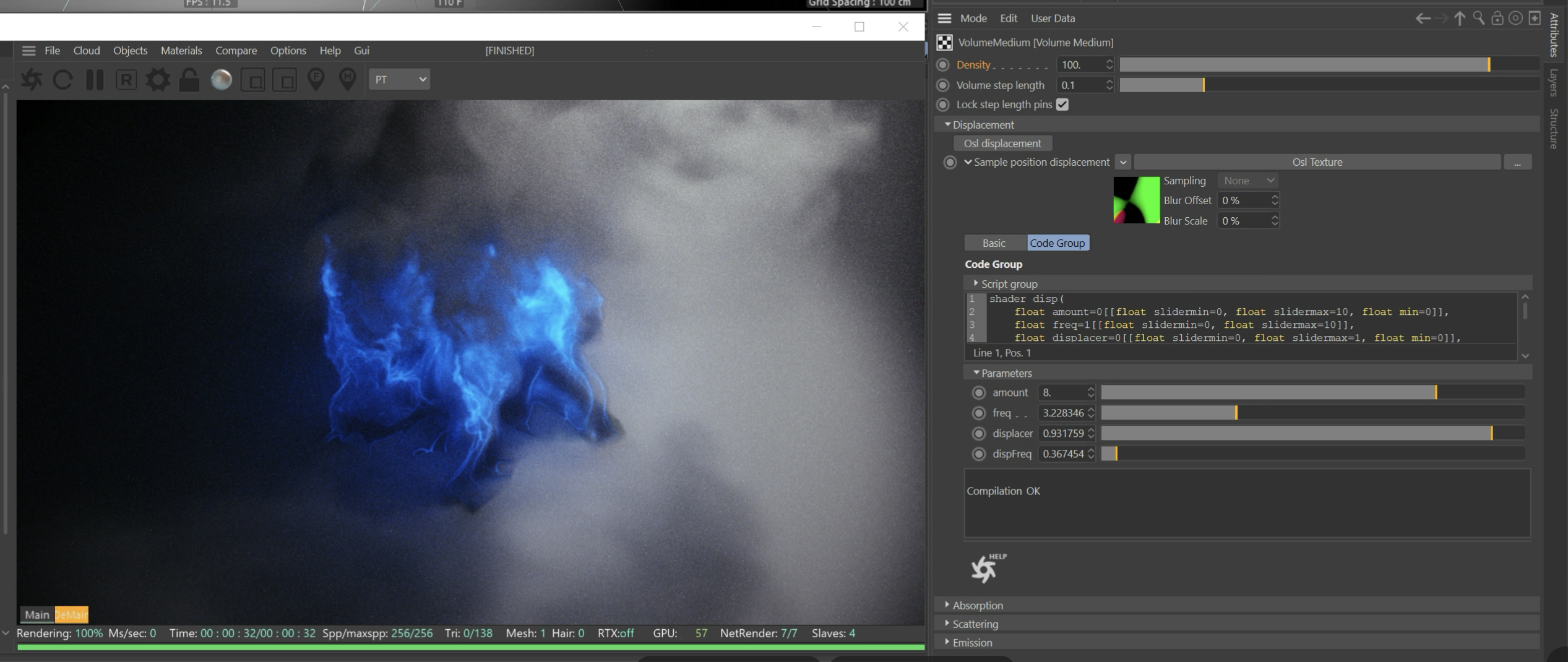

you need v202.1 to be able to have access to the Displacement Volume channel, and like for materials, it is a unique channel per Volume node:
ciao Beppe
