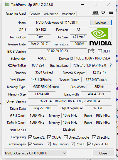

Please, download and run GPU-Z:
https://www.techpowerup.com/gpuz/
And share a screenshot from the Graphics Card tabs from both GPUs, thanks.
If it crashes with Tonemapping active, probably the PCI bus of the second GPU is too slow.
Please also post a screenshot from c4doctane settings/Devices panel, thanks.
ciao Beppe
Re: PC chrashes when activate both "Use for tonemap"
Posted: Wed Dec 11, 2019 9:59 am
by moebius
Hi Beppe
here some screenshots, thanks a lot!
Posted: Thu Dec 12, 2019 8:40 am
by bepeg4d
Please, try theses steps.
  • Go to Nvidia Control panel, menu Help, and enable the Debug Mode, to work with GPUs at default clock.
  • Connect one monitor per GPU, to reduce the available VRAM more uniformly .
  • In Devices panel, enable the Priority for both GPUs, and set the Priority popup to LOW
ciao Beppe
Posted: Thu Dec 12, 2019 11:25 am
by moebius
nop. :-(
But actually, I don't need "Use for tonemap" for both GPU, so I break up to test stuff...
