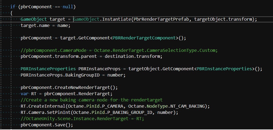

Oops, I forgot to include some of the code for context. Here it is:
Re: Automating Octane Baking for Unity - Octane API Problems
Posted: Fri May 03, 2019 1:19 pm
by ChrisHekman
SamuelAB wrote:Hi, it's all working except a little thing, The film resolution does not follow through.
In Unity it is 2048 x 2048, but in Octane it is 512 x 1024 for some reason. Would you know a line of code to fix this?
I am also assuming there is not documentation for Otoy's API in Unity? If there is, please let us know where we could look :)
Thank you for you help!
There are two places you can see the Octane API. One is in visual studio. When you go to the Octane.Node definition you should be able to see all the available functions.
To see what PinIds each node type hs, you can open the OctaneGUI inside of unity and right click on a node and select "LUA API Browser"
Code: Select all
RT.FilmSettings.SetPinInt2(PinId.P_RESOLUTION, 2048, 2048);
