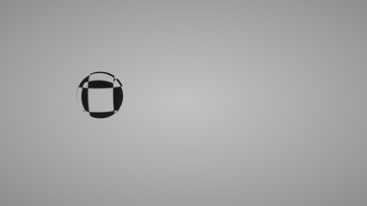

It looks like the triplanar Object space and worldspace coordinats is broken.
They both act the same unless i misunderstand how they are suppose to work.
This is how i think about it.
- You create a sphere in your 3ds max scene.
- You animate it from left to right.
- You apply a triplanar texture map to it and pick Object space.
This should make the texture stick/lock to the object.
- You now change it to worldspace
This should make the texture slide across the sphere because the sphere is animated.
At my end i get sliding on both systems.
UNLESS!!!!
I check the movable proxy on the sphere, then object space works as it should.
Is that intended? Do i really need to make all the objects containing this triplanar material to be movable proxy to make it work correctly?
They are both objectspace in the triplanar - But the first one is movable proxy and the second is not.
https://media.giphy.com/media/5UtdqOjGf ... /giphy.gif
https://media.giphy.com/media/WysDPT1Nq ... /giphy.gif
-Mats

Here Paride
I have attached the maxfile in this post.
Here is the renders i made with this file, just for references to see if you get the same result.
Here is frame 0 and 5, the sphere DON'T have movable proxy on.
Here is frame 0 and 5, the sphere DO have movable proxy on.

I have made a new test scene, this time i have based on this
https://docs.otoy.com/3DSMaxH/3DSMaxPlu ... narMap.htm
So we dont need to complicate it with maps, only colors.
The results i get:
Movable proxy off
Movable proxy on
The sphere is here animated between frame 0 and 5 with a 90degree rotation in Z
And the triplanar shader is set to object space on all the renders.
I would really appreciate it if you had time to take a look on this maxfile aswell.
Thanks for the help
-Mats
