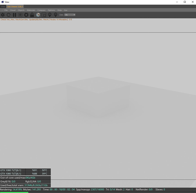

To see this problem, just open the scene and first thing you do is just push the render button.
You should see render like this:
If you go to OctaneSky and in Env Tag reload texture, it should now work correctly and you should see render like this:
If you now save the scene, and close the project, open it again, and hit the render button, it should now work without reloading.
