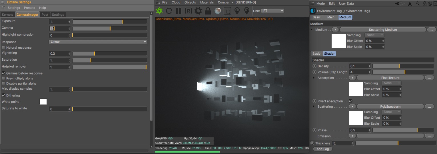

I have opened your file, disable the Volume, and re-enable the Environment node with correct settings:
volumetric_test_envMedium.zip
(77.25 KiB) Downloaded 332 times
The Medium radius value is very important, works in meters, and need to be set in relation with the dimensions of the scene, in your case, 5m are more than enough.
Then you need a very low Density value under 1, to simulate the foggy air.
Finally white absorption, and scattering, and a bit of Phase value to enhance the scattering effect in the direction of light.
The dimension and power of the light is also important, I have added an IES file to better concentrate the light in one direction.
