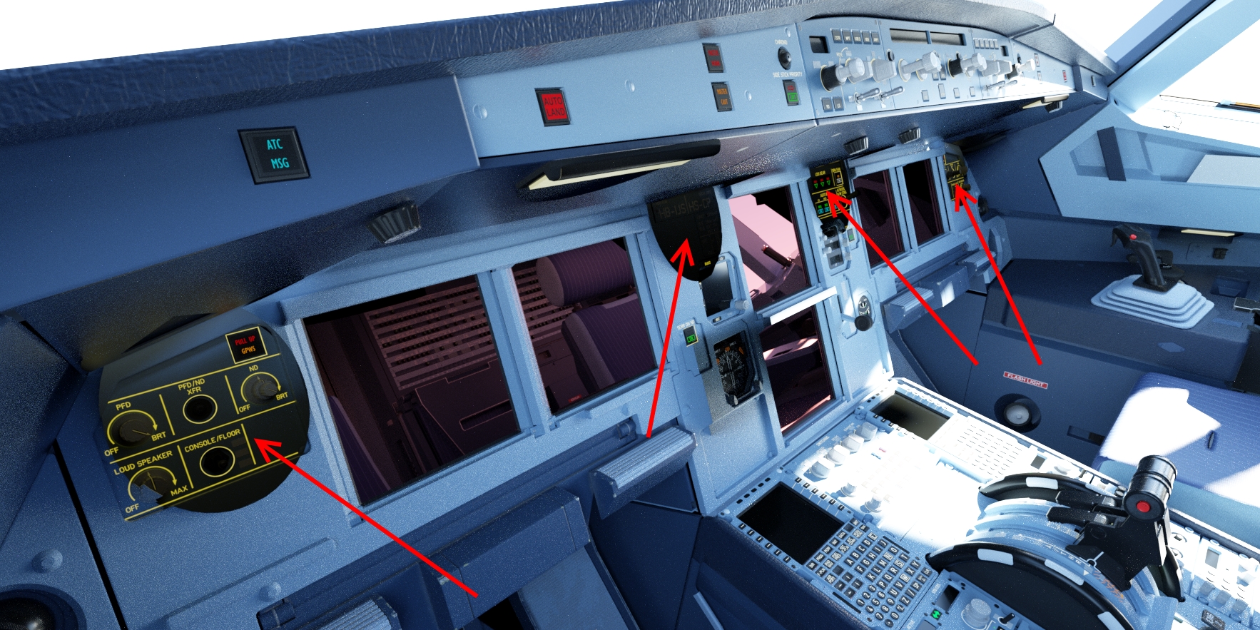

By the way, I noticed that the spot lights on the instrument panel project a black circle. Is this a bug or are spotlights not supported?

Posted: Mon Dec 18, 2017 11:03 am
by Xhed
elecman wrote:By the way, I noticed that the spot lights on the instrument panel project a black circle. Is this a bug or are spotlights not supported?
Could you provide me with a screenshot showing the issue?
Re: Quality control
Posted: Tue Dec 19, 2017 12:30 pm
by elecman
See the attached image. The black spots are caused by the spotlights called "instrument flood light".
