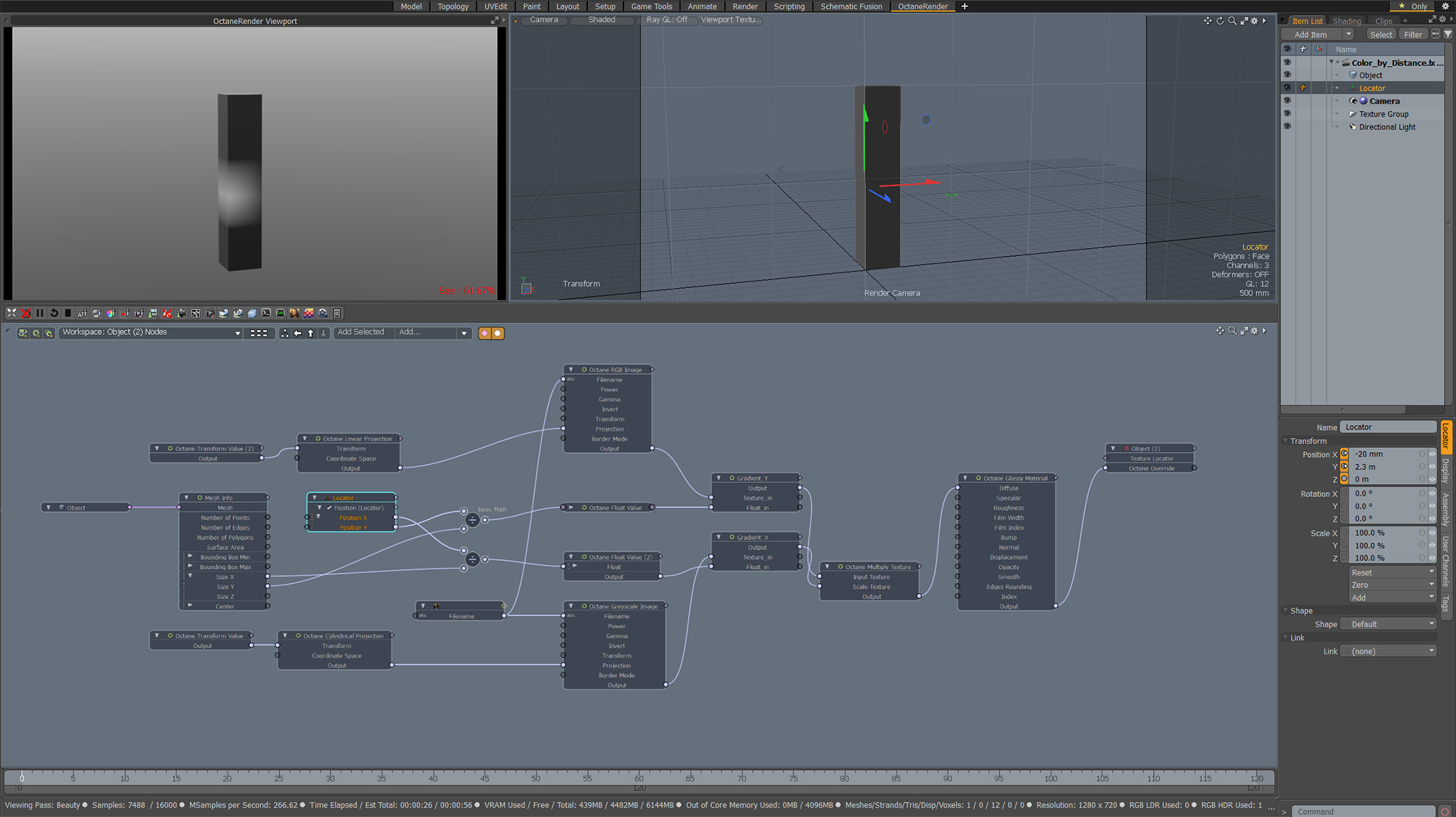

Hey there,
maybe you can use this "hacky" approach: I basicly connected the locators position to a gradient:
I thougth i can just do this for the x y and z axis and multiply the results. It kind of works but it's not that pretty. Btw. @Paul is it possible to feed multiple Float values into a NodeGraph? I can create multiple Inputs but there are not present in Modo.
Greetings!

by Hesekiel2517
Ok, i thougth about it and build another rig. This is much simpler and looks better:

Thanks a lot for the answer.
I finally found some similar solution but your rig seems more sophisticated !
