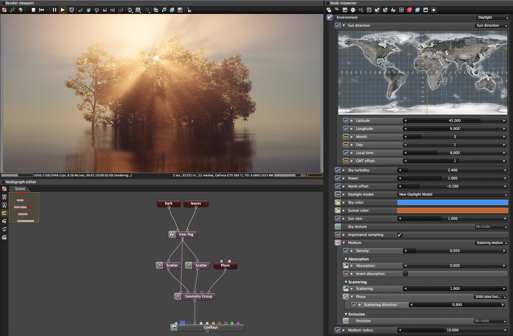

Hi sachakogel123,
ops, sorry, here is the image:
Another solution is to use a geometry with special specular material with index 1 and medium node with the same settings as the Environment medium node, but the camera cannot be inside the geometry, or to use a VDB volume as explained here:
