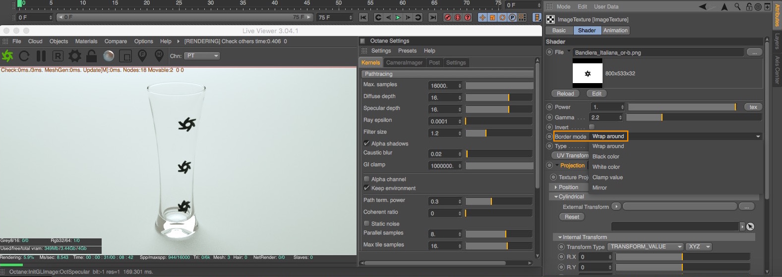

somehow my image texture appears multiple times, i enabled the alpha channel, i tried to increase the size of the image but it didnt work out. :(
so if anyone knows a solution, please let me know.
thanks

you have to change the Border Mode inside the Imagetexure node.
With the default mode Wrap around, the texture is tiled over the mesh:
based on your alpha image, you can chose different settings, in this case White color is the right one:

Hey bepeg4d,
thank you, but already found out that the texture appears on the other side of the glass because of its thickness
