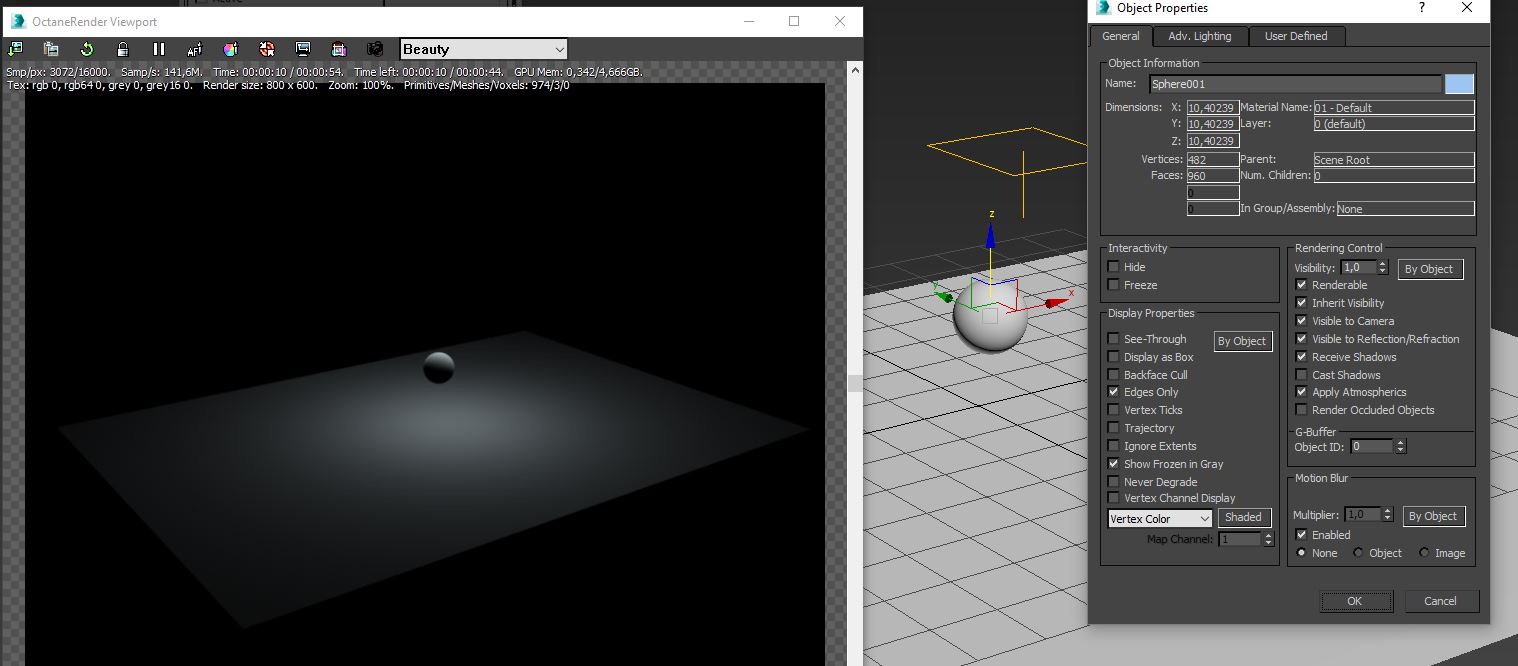

Hi, is it possible to prevent a mesh from casting shadows but still been visible to the camera in the octane plugin for modo.
Since the shader controls in the shader tree don't work with octane overrides how can i make this work?
Andrea

Should be a check box in the Mesh Properties of the Selected mesh. Havent tried it myself, but pretty certain its that.

Thanks for the reply Lfedit but that seems to affect the receiving shadows on a mesh and not the contrary.
I have a plane with an image in front of a window. I want it to be visible in the render but I don't want it to occlude the Gi and to cast shadow in the room.
In modo its pretty easy to do and even the in the 3dmax version of the octane plugin this is possible, but I can't seem to find a way to do it with the modo version.

Hi Andrea - can you explain how you do this in the 3ds max plugin pls?
Paul

For Cast shadow. It just works in max....

I just checked - and LFedit is right - unticking Shadow Visibility stops that mesh casting shadows.
Paul
