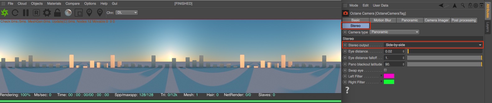

you can specify the stereo format in the proper tab of the Camera Tag in the "Stereo output" pop-up menu:
C4D-VR-360_stereo.c4d.zip
(38.43 KiB) Downloaded 200 times
You can choose Side-by-side or Over-under and you have to correct the render aspect ratio accordingly.
