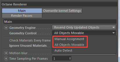

True, seems a bit above what I need to know. Thank you for the tip with the layer manager.
I had to use 'send all data' as my deformer wouldn't update correctly when rendering. Unless there is another way around that.
I'll try that next time when I encounter a crash or error.
Thanks again! :)
Re: Scene Render Crash
Posted: Tue Aug 23, 2016 3:28 pm
by aoktar
Ok i see. When some meshes are not updating try this option. I'm gonna check this issue after come back from a vacation.
Or this options
