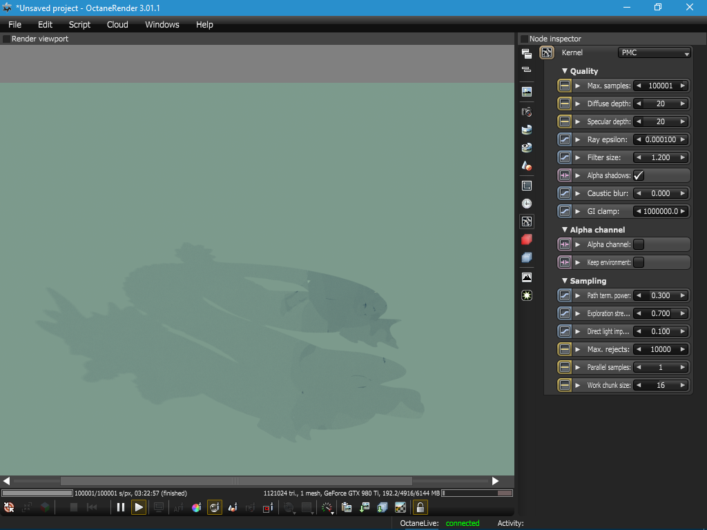

Hi, guys.
Dragon invisible test at resolution screen of 1002x602:
-- v3.01.1b:
-- v2.25:
I get caustics later using v3.00~v3.01.1b at same samples per pixel (S/px or spp). :? :(
PMC default settings except few things - see right of 1st image
Specular material for dragon default settings except:
- reflection and transmission 1.000
- índex of refraction 1.000
I hope the caustics will be better/earlier than v2.2x or this issue will be fixed to undo as v2.2x.

Can you upload the scene you're rendreing?
And also, what effect does this have on the scenes you're rendering? Usually, if an object like a window is supposed to be invisible or transparent to light rays (for instance windows) the material will have the "fake shadows" option enabled. If you see caustics in the scene from an object, this object will have an IOR different from 1, and usually you set the caustic blur in the kernel settings to a small value, like 0.01, so the caustic will be rendered faster (but slightly blurred).

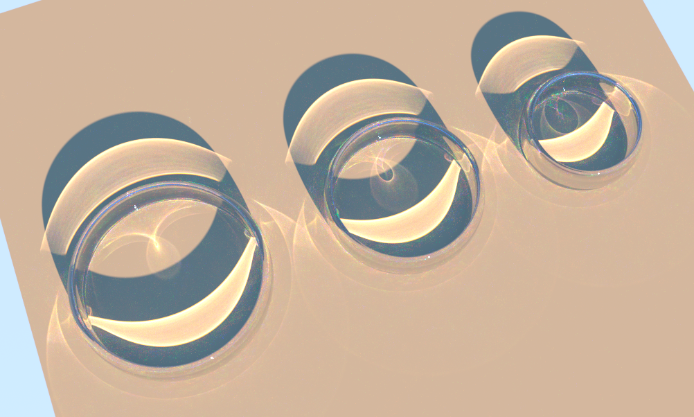

Wedding glass test:
-- v2.25
wedding@1002x602 - daylight-08h@50diff+52spec-depth,10k-reject_151705 spp-7h56min.png
-- v3.01.1b
wedding@1002x602 - daylight-08h@50diff+52spec-depth,10k-reject_151705 spp-4h58min.png
PMC default settings except:
- 151705 spp
- 50-diffuse and 52-specular maxdepth
- 10k-reject
- parallelism 1
- caustic blur 0.000
v2.25 is better caustic = more realism than 3.01.1b (look 3rd ring on right) but v3.0x is ~2x faster than v2.25.
See caustics "cleaned" for v2.2x only. :)

Wedding test - caustic blur 0.001:
-- v3.03.3
-- v2.25
v2.25 continues to be better and more visible caustic (3rd ring on right). I prefer v2.25 until the issue fixed. ;)
