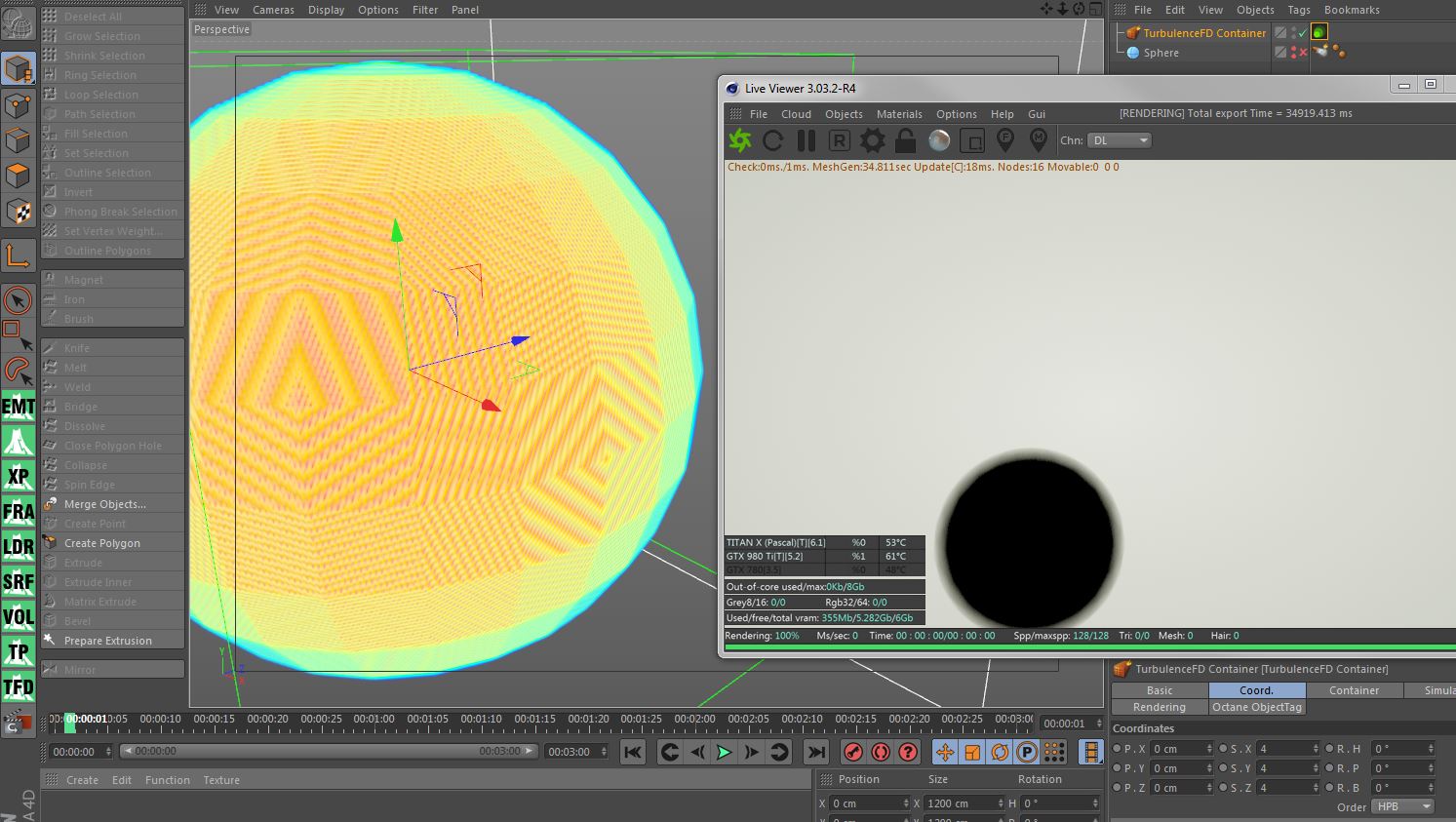

I have jet flying through a TFD container moving on xy & z with a slight banking rotation. The emitter is a disk in it's thrust area. When I run the simulation the sim particles appear where you'd expect, right where the emitter is positioned. When I render the simulation using an octane tag the position is off in XY & Z, by a few cm each. Anyone Have any ideas why this is happening? Even a small cube moving through a TFD container on the X axis has this problem. Is it a scale thing? I scaled my model down pretty significantly to allow for a smaller container.
I tried having the container as a child of the jet and positioned at the thruster but that doesn't work either.

The volume is not rotating. I saw another forum post so I abandoned that. The volume is static, the missile is flying through it. Straight line in X.
I did another test with a cube. It seems to be a scale issue. When the cube is large 25x25x25 and above the simulation renders correctly in the right spot. If I shrink the cube to 3x3x3 it's not positioned correctly.
3x3x3cm
3x3x3cm
50x50x50cm
50x50x50cm

Sorry for the delay here is the a similar scene. Not being able to rotate the container is a problem. I want the smallest container possible. If your model isn't zero'd out on rotation you have to tinker with the wind settings to get a flow to react properly, instead of just rotating the container to match your model and saying wind +1 on X. So, in order to keep a small container and small voxels I scaled my model down. Now the emitters render location is off. Is there a fix in the works? Between this and the realflow issues I'm having a hard time with Octane right now.
