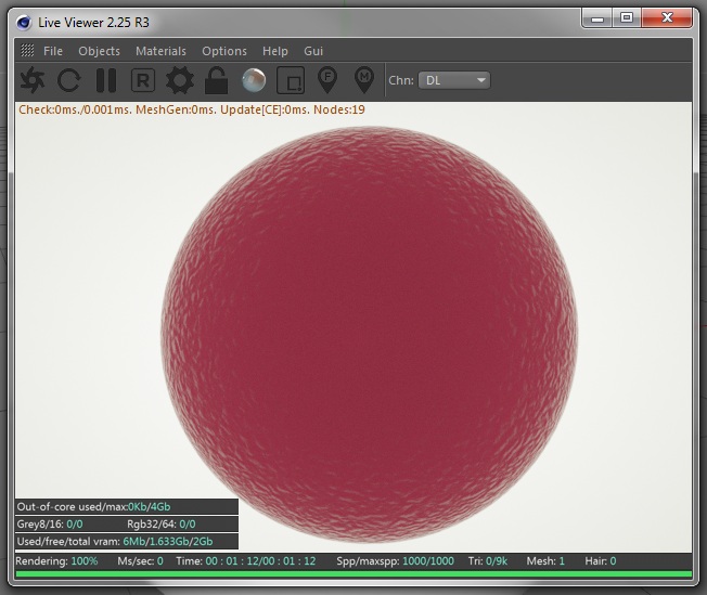

the Scattering Medium in my C4D Plugin (3 Alpha, 3 Beta) works wrong for me.
for Example:
this is what i get with the "Raspberry" Material from Live DB in the 2.25 Version
And this i get with the 3.Alpha, Beta
Another Example:
This is the "Red Reflective Skin" from Live DB in 2.25
and this is the same Material in 3.Alpha and Beta

Ok, here is what i've found out so far.
The Absorption Channel in the Scattering Medium works inverse in the 3 Alpha v and above.
The Standelone has a "Invert Absorption" checkbox to fix that, but how can i fix that in my Plugin?
Regards Michael
