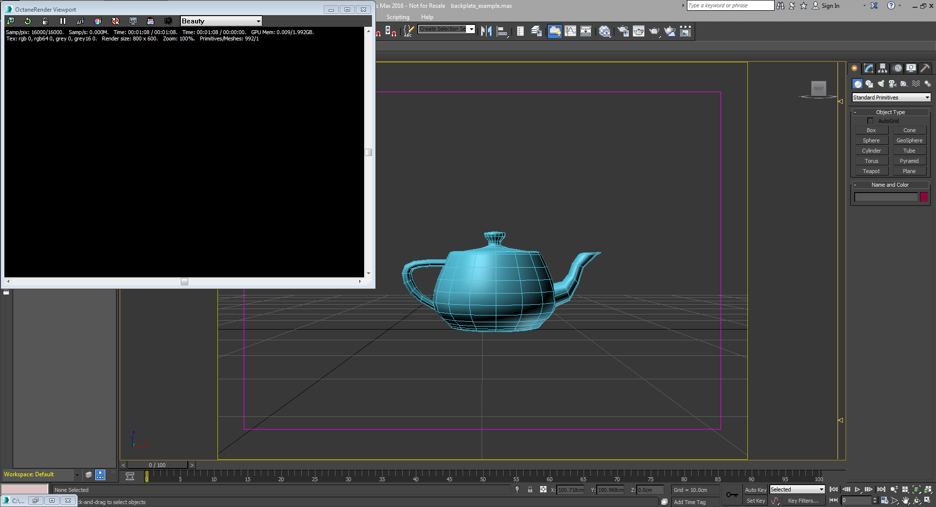

Here is the workflow:
Start: This scene has one object, and no lighting
Step 1: Press Alt + B to bring up the Viewport Configuration window. Click the "Background" tab. Choose "Use Files:", then click "Files..." and select you background image.
Step 2: In the Render Setup window, under "Kernel", tick "User viewport background". Under "Kernel Type" tick Alpha channel". Make sure that "Keep Environment" is unticked
Step 3: Bring your Environment Map into the scene. Open "Environment and Effects" and drag the Map into the Environment Map
Final Result:
Hopefully this answered your question. Please let me know if this helps you.
