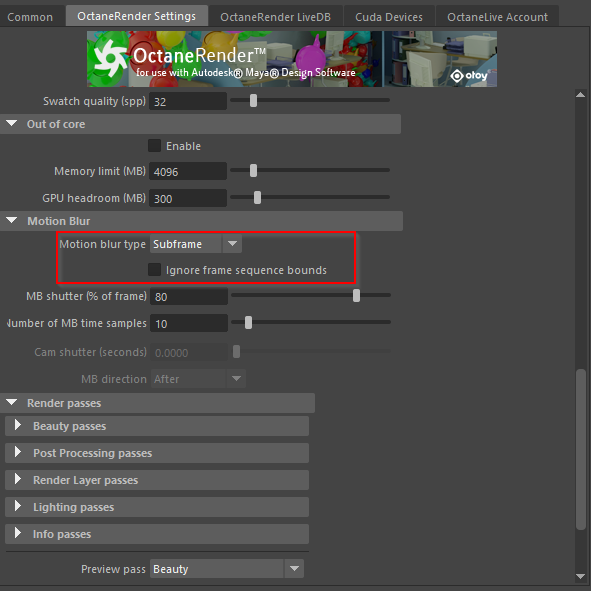

Subframe with ignore option
Subframe MB needs an additional frame at the end of the animation. The less error prone way to do that is to hit the checkbox "Ignore frame sequence bounds".
This enforces to stay in the frame range, but therefore the last frame (10) does not get blurred (no frame 11 to blur with).

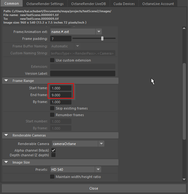

Subframe without ignore option
Without hitting the checkbox you have to limit your framerange yourself, so for 10 frames in the timeline the frame range can be 1-9.
Or you add one more frame in the timeline.

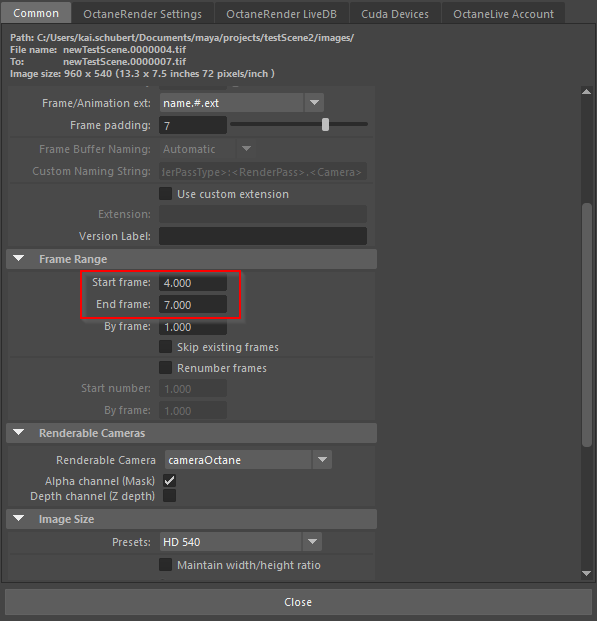

Here it is 3 frames at the beginning and end, so with 10 frames on the timeline, you can set the range to 4-7.
I can as well add 6 frames to the timeline (16 total) and set the range to 4-13.
