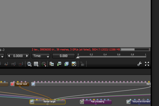

It's not a plugin issue. Main Program issue.
Octane 3.00 alpha4 Import 39.9 M Tri Polygons
Render Failed 5824.7MB/12022MB/12288MB

The screen shot was from the Standalone. There you can find the log under Help -> Open log....
