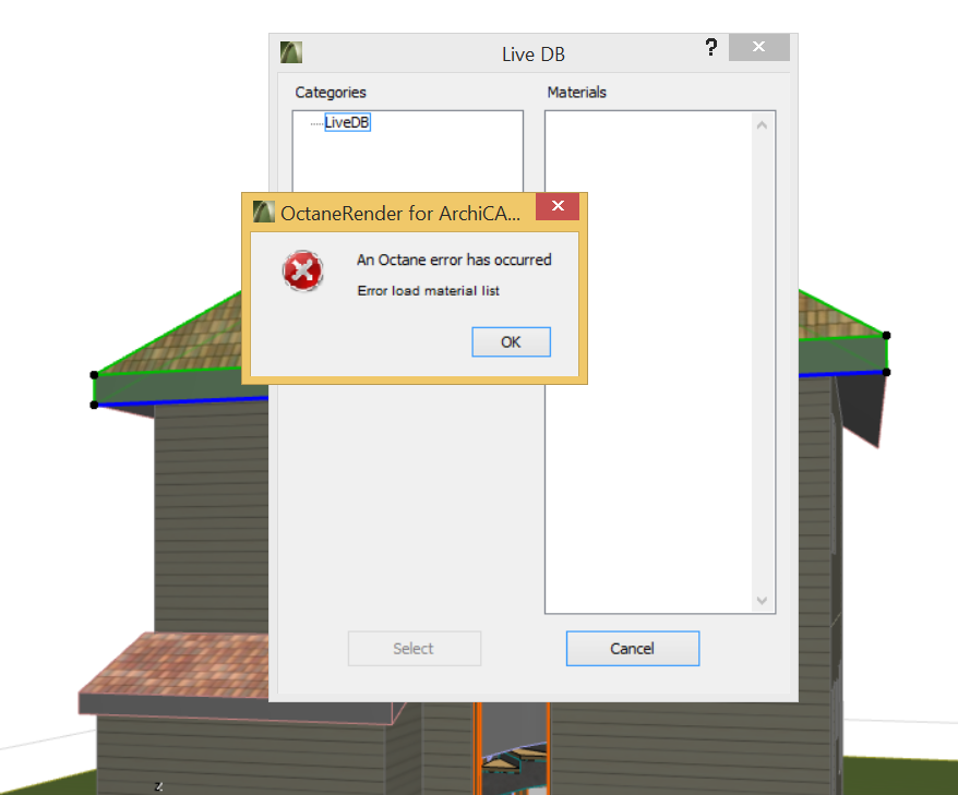

I've purchased Standalone 2.x and Graphisoft ArchiCAD Plugin 2.x. To my surprise, 2.x plugin doesn't support 16x ArchiCAD though it is listed as supported when purchasing, so I come along with 1.5x version with which I have following issues:
1. When trying to download LiveDB material, ArchiCAD 16 have kept crashing though I could search for material in LiveDB, and now it just can't load any LiveDB content.

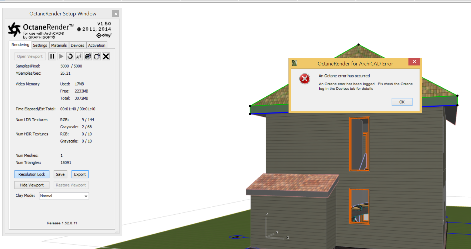

2. When trying to save scene to either .ocs or .orbx the following error appears
(a copy of CUDA Log):
Started logging on 05.09.15 09:48:49
OctaneRender version 1.52 (1520000)
Save OctaneRender Scene: Could not write OCS file 'C:\DATA\_'.
Failed to open destination package "C:\DATA\_
Save OctaneRender Scene: Could not write OCS file 'G:\_'.
Any support is welcome)
Is ArchiCAD actually crashing, or is the plugin just popping that msg? That message indicates that the plugin detected that the OctaneLive servers (which host the LiveDb) were offline. There have been a couple of reports of this problem - and Otoy are currently investigating the issue.
This may be due to trying to export to a folder that you do not have write permissions for. Does it export if you save to your Documents folder?

Installation of the latest release have solved all issues with plugin.
And export works, when the destination is non-OS drive.
