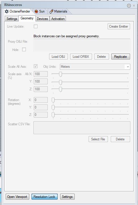

You need to click the Live Geometry checkbox in the Geometry tab for each item in the scene, OR Settings->OctaneRender->Live Updating=All Meshes Live. Then each mesh will be a separate Mesh object in Octane and you can enable the Object Id pass and then select it from the Viewport render pass combo box.

Ok, I tried both methods, tried it in several scenes, with blocks and normal objects, exported it to Octane standalone, but no, all objects have one id and are displayed in a dark red in Rhino and Octane sa. All the other passes work. Only the object id doesn't.

Setting the 'Live Update' Flag or through settings, and then saving as ocs and then going through each of the meshes, editing the properties and choosing single object instead of hide (which is set by default) I can have the correct object id's.

Attached is a screenshot showing it works - and the rhino scene from the screenshot. Perhaps that helps you?

Ok, that is totally different from what I have. It seems you have a newer version.
Edit: I have Rhino 5 x64 SR11
MySettings
MySettings
MyVersion
MyVersion
