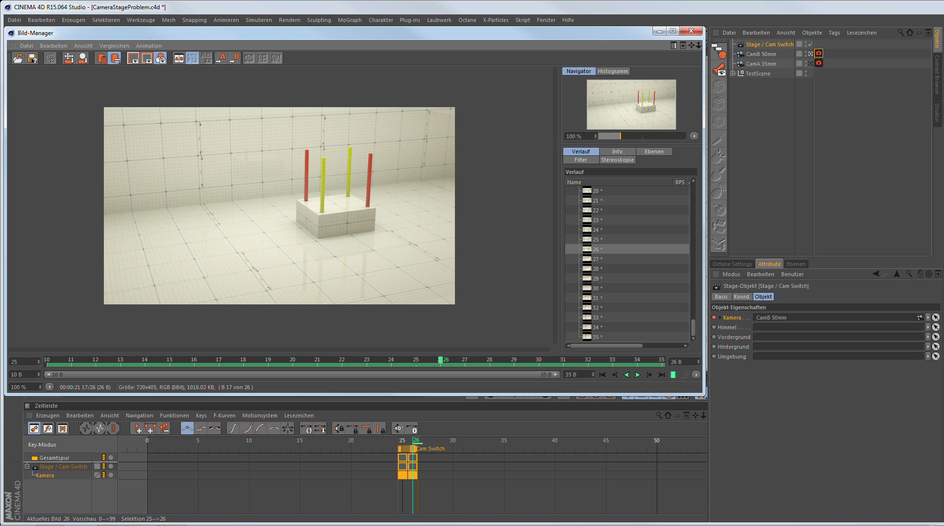

during my last project I realised there is a bug with the stage camera object switching between two cameras, that have motion blur activated.
It only accurs, if the 2 octane cameras have different field of view (thats what I discoverd so far). It is not there, if both cams are set to the same FOV.
It is also gone, when you disable the motion blur.
And most important: It only occurs in final rendering! with the picture manager, it is not visible in the live viewer!
SCENE: Stage Object switches between CamA (35mm) and CamB (50mm) from Frame 25 to Frame 26.
BUG: Frame 26 is rendered with a field of view of something between CamA and CamB, not with the field of view of CamB. Frame 27 is fine again.
Here some screenshots that show the problem in final render output.
Frame 25 with CamA at 35mm
Buggy Frame 26: mixed CamA and CamB FOV
Frame 27 with CamB at 50mm

i don't register the fov of cameras for motion blur.

i haven't tested your scene yet. But i'm doing some estimations. What can be a problem when you immediately switch from camA to camB. It's not important to do this with Stage object or some key frames. We check the results. Problem should be related with lack of FOV motionblur data. Octane needs to know all data to produce proper motion blur. If i don't register some required, it can't produce expected result. Atm, i'm giving only matrixes for a camera.
Of course i can add this support, but need some fundamental changes on engine. Noted.
