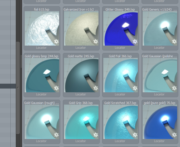

this LiveDB update turn some previews bluish...just previews, the materials are correct. look:

by face_off
I have found the issue with the LiveDb preset thumbnails above, and this is fixed in the next release of the plugin. I have refreshed the LiveDb download with the corrected thumbnails, so pls re-download LiveDbPreset.zip (you don't need to redownload the texturemaps).
